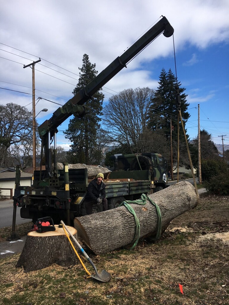

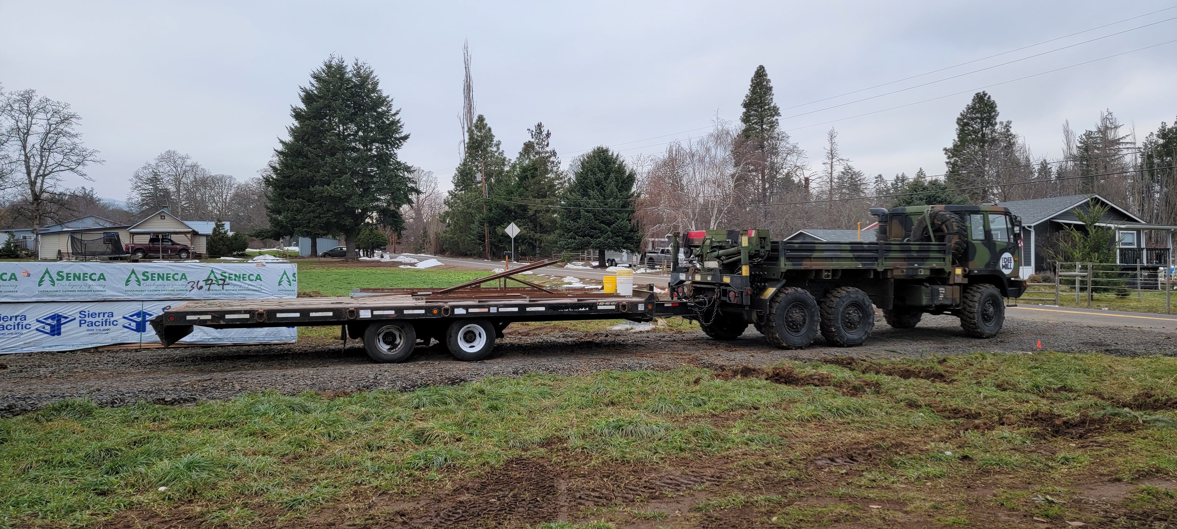

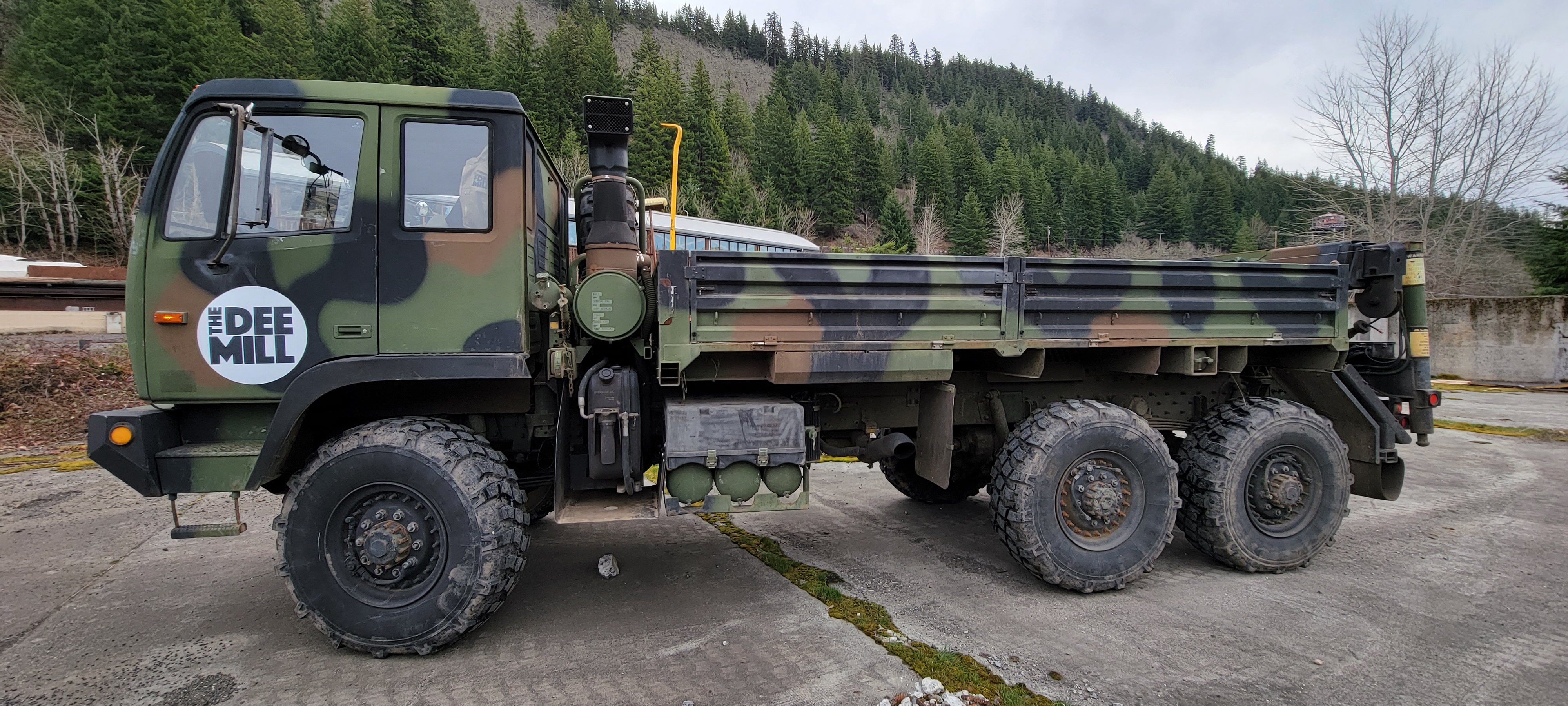

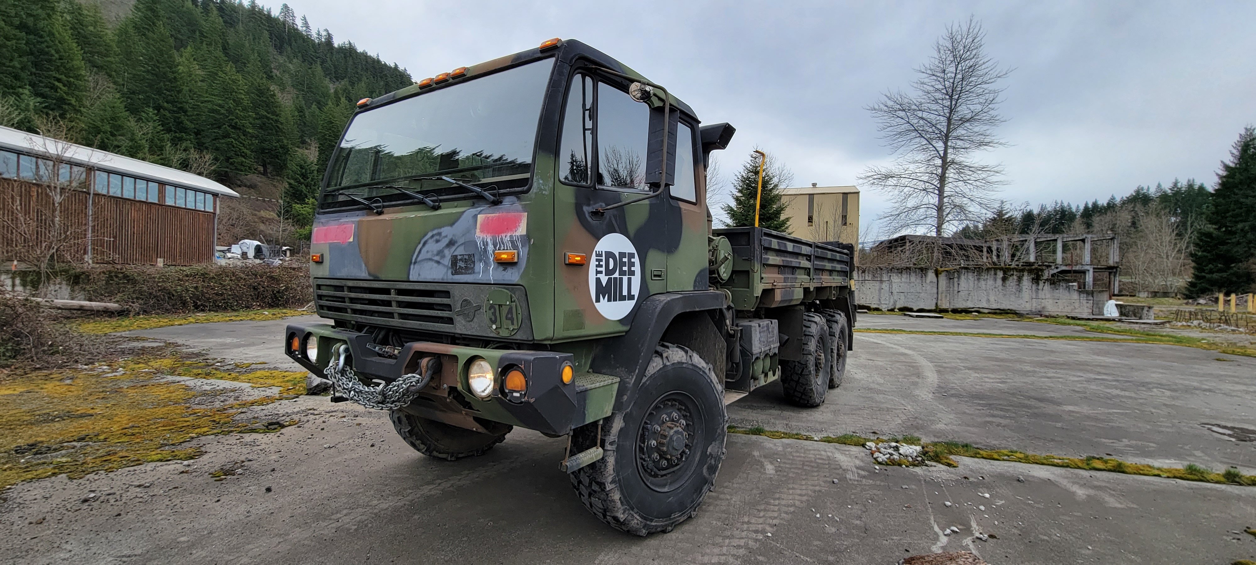

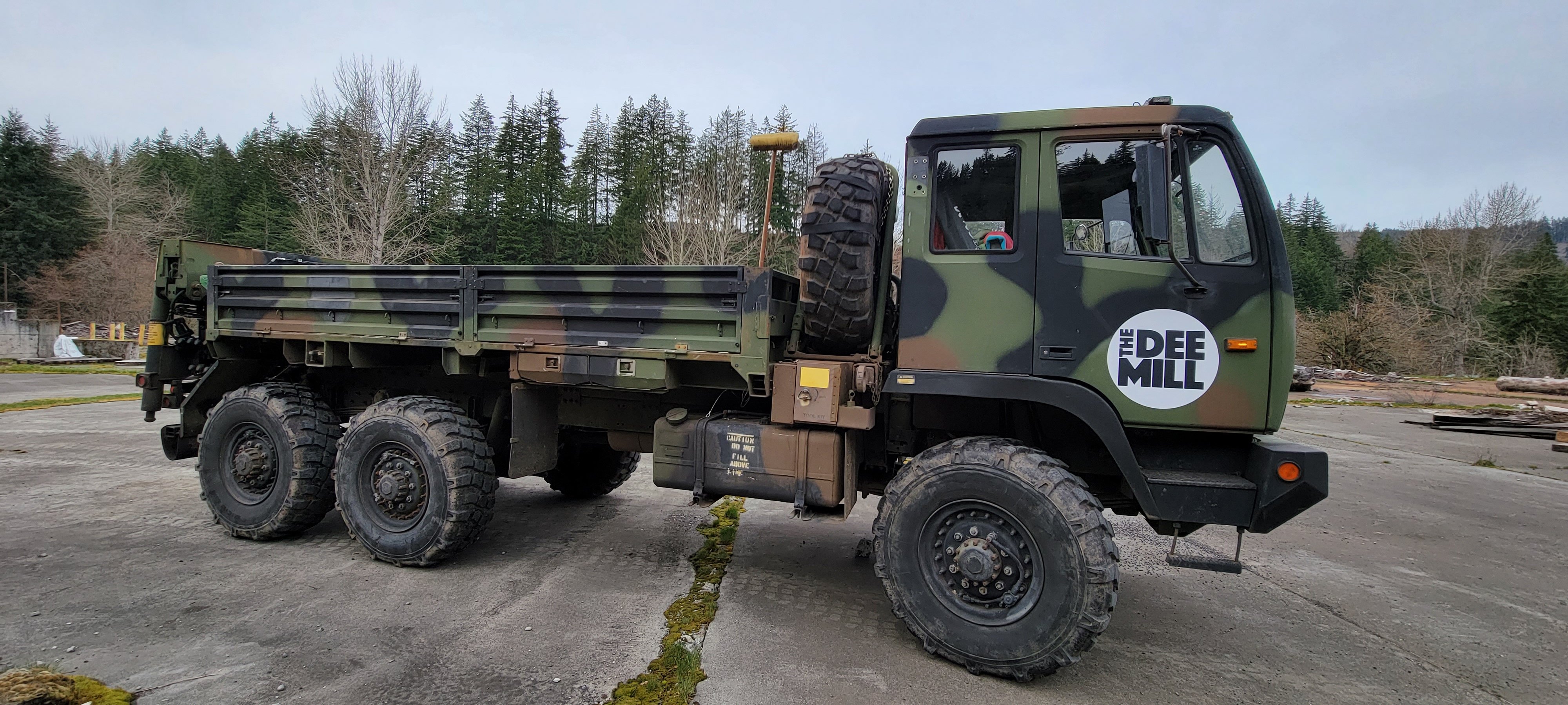

The Dee Mill is selling our urban/rough terrain reclaimed log salvage crane truck. These are impressive and iconic vehicles and this one in particular helped get our business off the ground. I know some people build these trucks into expedition campers.
I am the second owner of this vehicle, after the US government, and have kept it in top condition. The truck was refurbished and fully serviced by a local FMTV specialist, including full rebuild of the crane. All systems are in good working condition, including the Central Tire Inflation System (CTIS) which we use on almost every salvage job to avoid messing up clients' yards. This truck is driven multiple times per week; it is not stale.
Registered with the Oregon DMV as a truck with Oregon plates.
Located in Hood River, Oregon.
@thedeemill.com (note: if you are interested in buying the truck, please do not call the Dee Mill phone number; the mill manager is getting tired of fielding calls)
Truck specs:

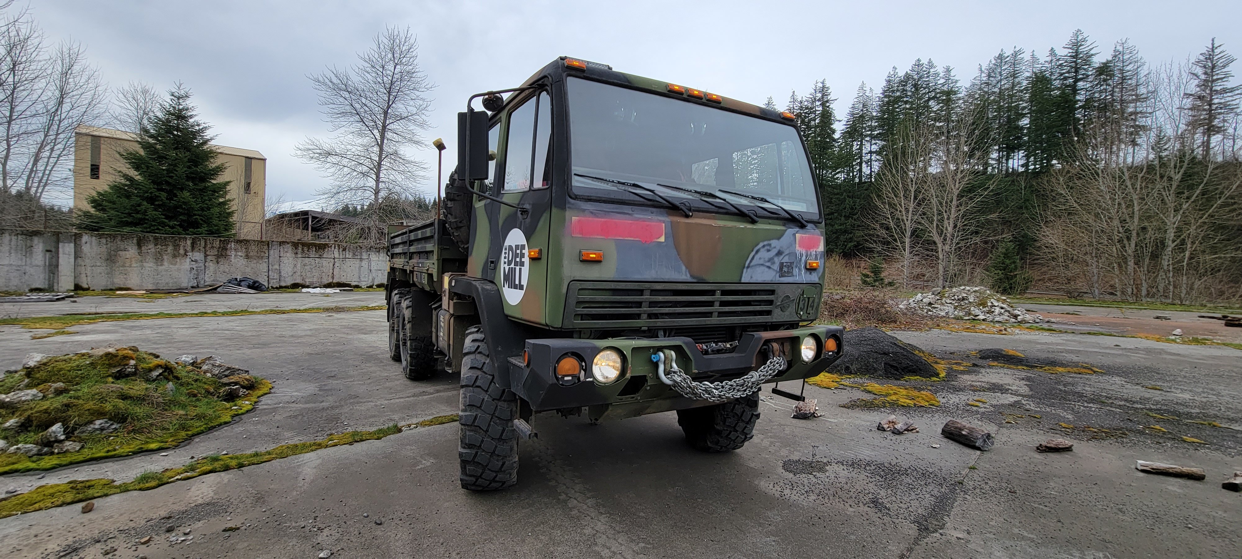

  • 1999 Stewart & Stevenson M1084-A1 5-ton
  • 10,000 miles
  • full time 4x6 with engage-able middle axle for 6x6 operation (we use this feature often)
  • 3126 CAT turbo-diesel engine, 330HP
  • Allison MD3070PT 7-speed transmission
  • Central Tire Inflation System
  • ABS brakes
  • exhaust brakes
  • wired and plumbed for towing

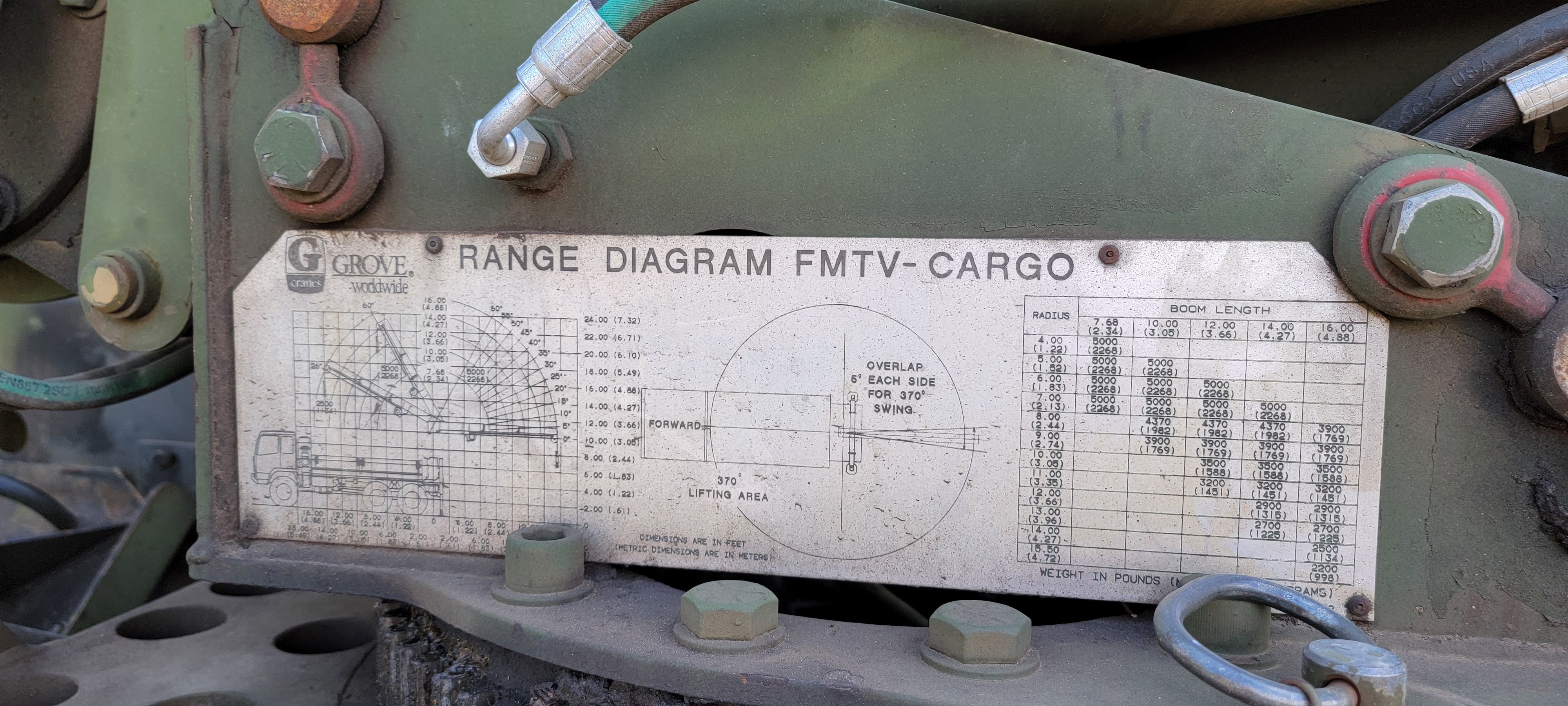

  • PTO-driven Grove knuckle boom crane with 5,000 lbs lift capacity (see load chart) and winch
$20,000 or best offer.
