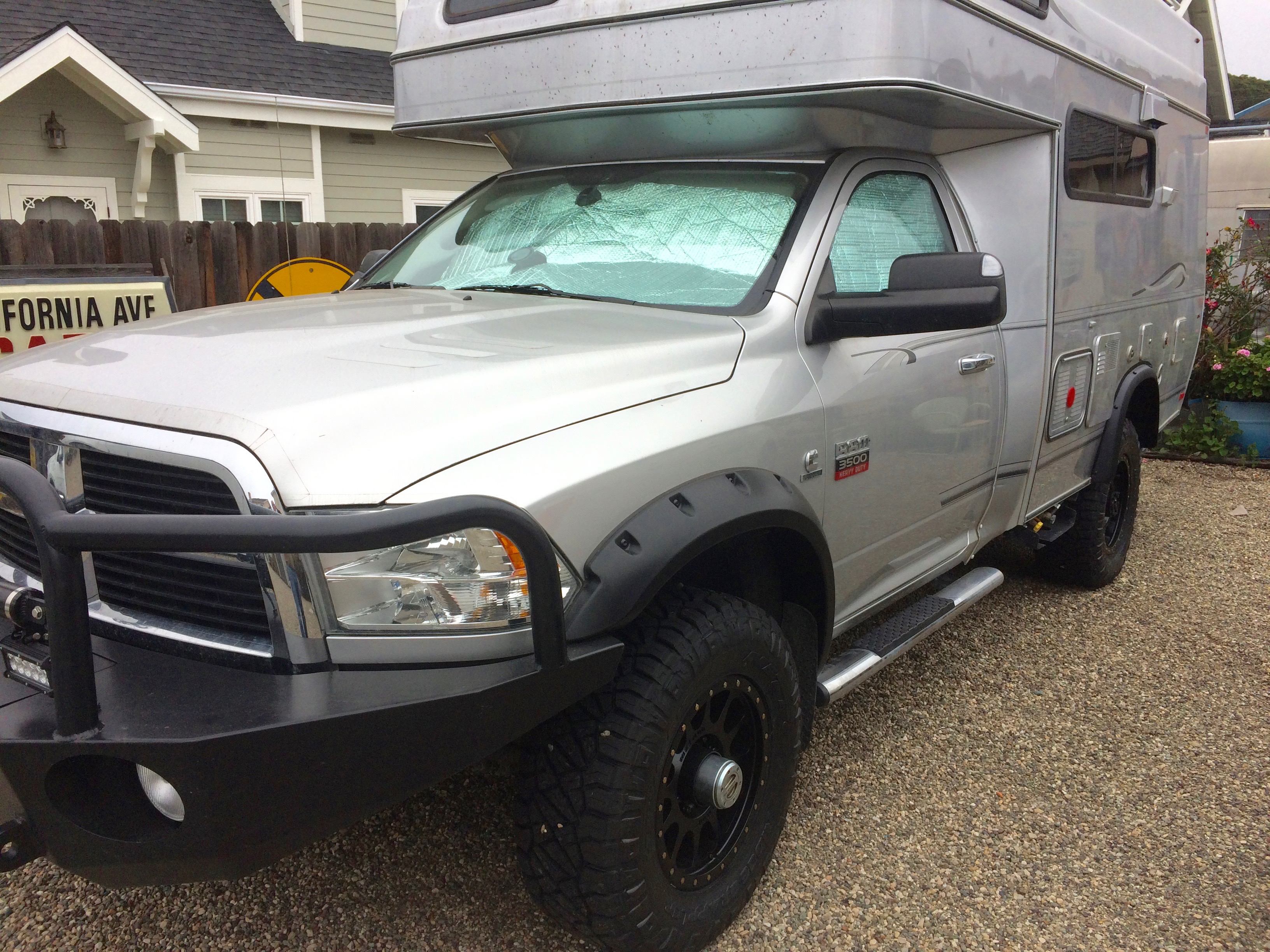

2" lift here. Road Armor front bumper and a little trimming clears 35's all day long.
<a href=""><img src="" title="source: imgur.com" /></a>
zip
I prefer social distancing.
Nice.
Where did you do the trimming? Looks pretty close on front of that rear tire.
Did you re gear?

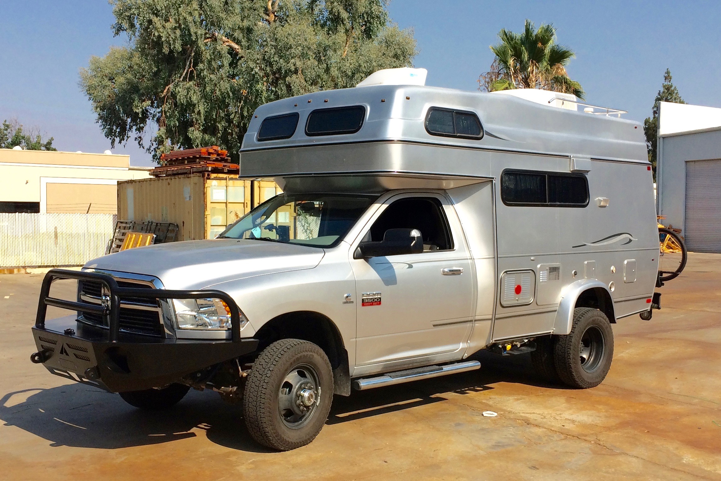

My stock Ram 1 ton next to a 90’s GMC 3/4. No lift on mine but 33.5” tall tires. Reference the driver mirrors, the 90’s 3/4 ton Tigers are short.

Nice.
Did you re gear?
Stock gearing. The 8.1, Allison, 35’s and 3:73’s is the perfect setup.
I trimmed a little non structural sheet metal on the firewall and was able to move the inner fender liner back 1”.
35’ 17” method rims, 18mm offset clears almost perfectly. I do rub the sway bar a tiny bit under full lock......no enough to bother or impede the truck ability.
the coach is wide and the rear tire is set in quite a bit.
might look close, thats the camera
