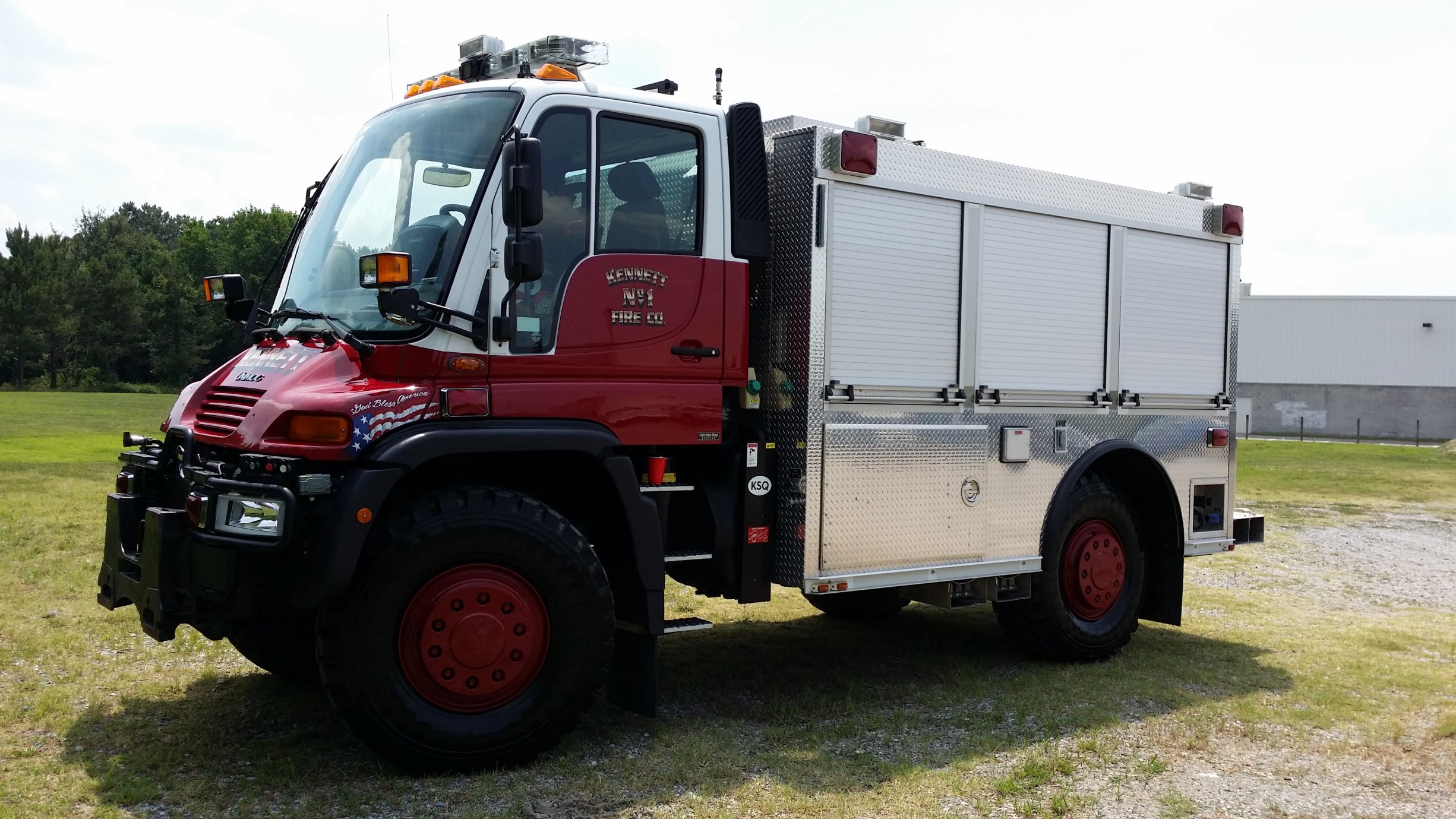

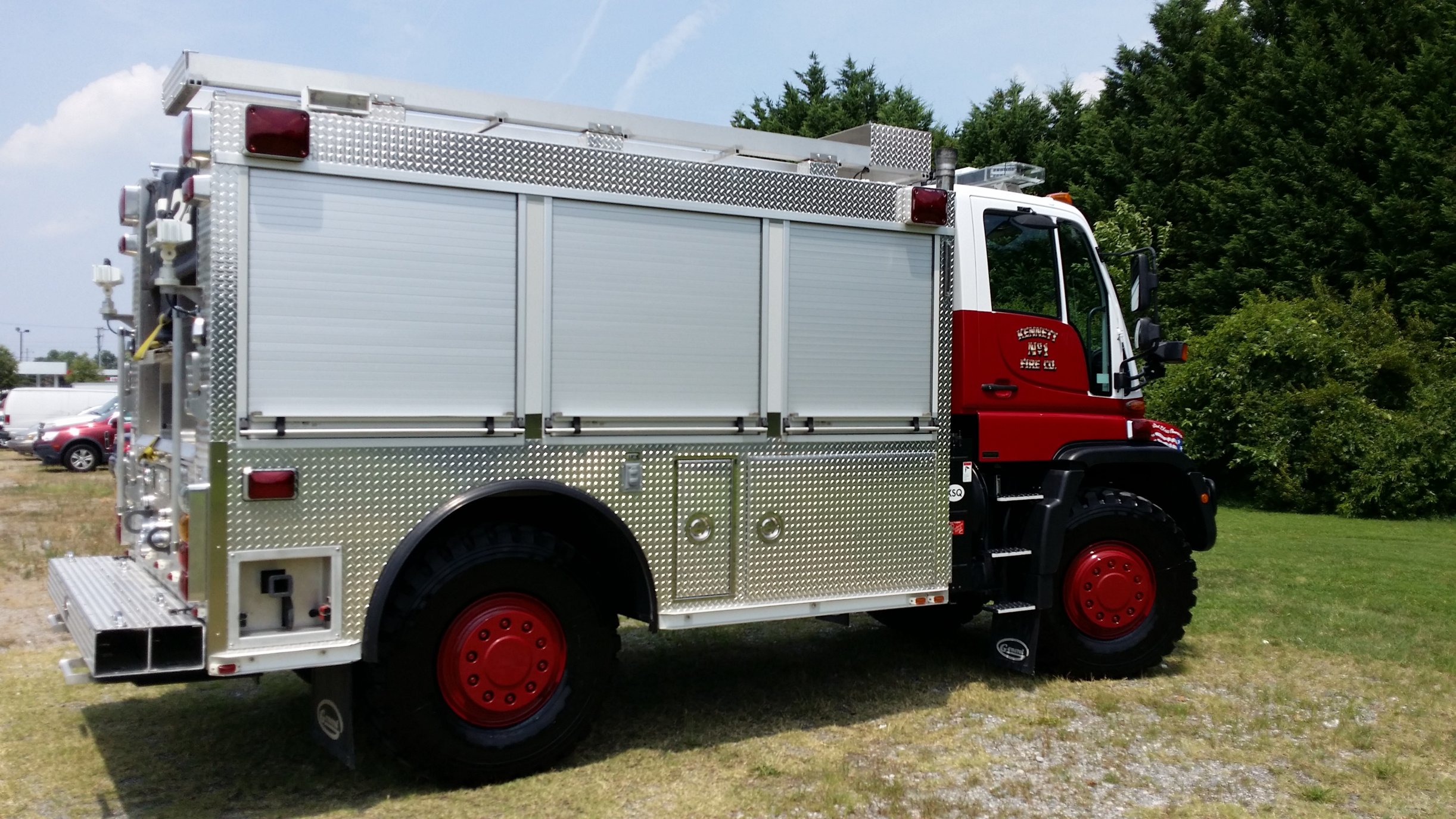

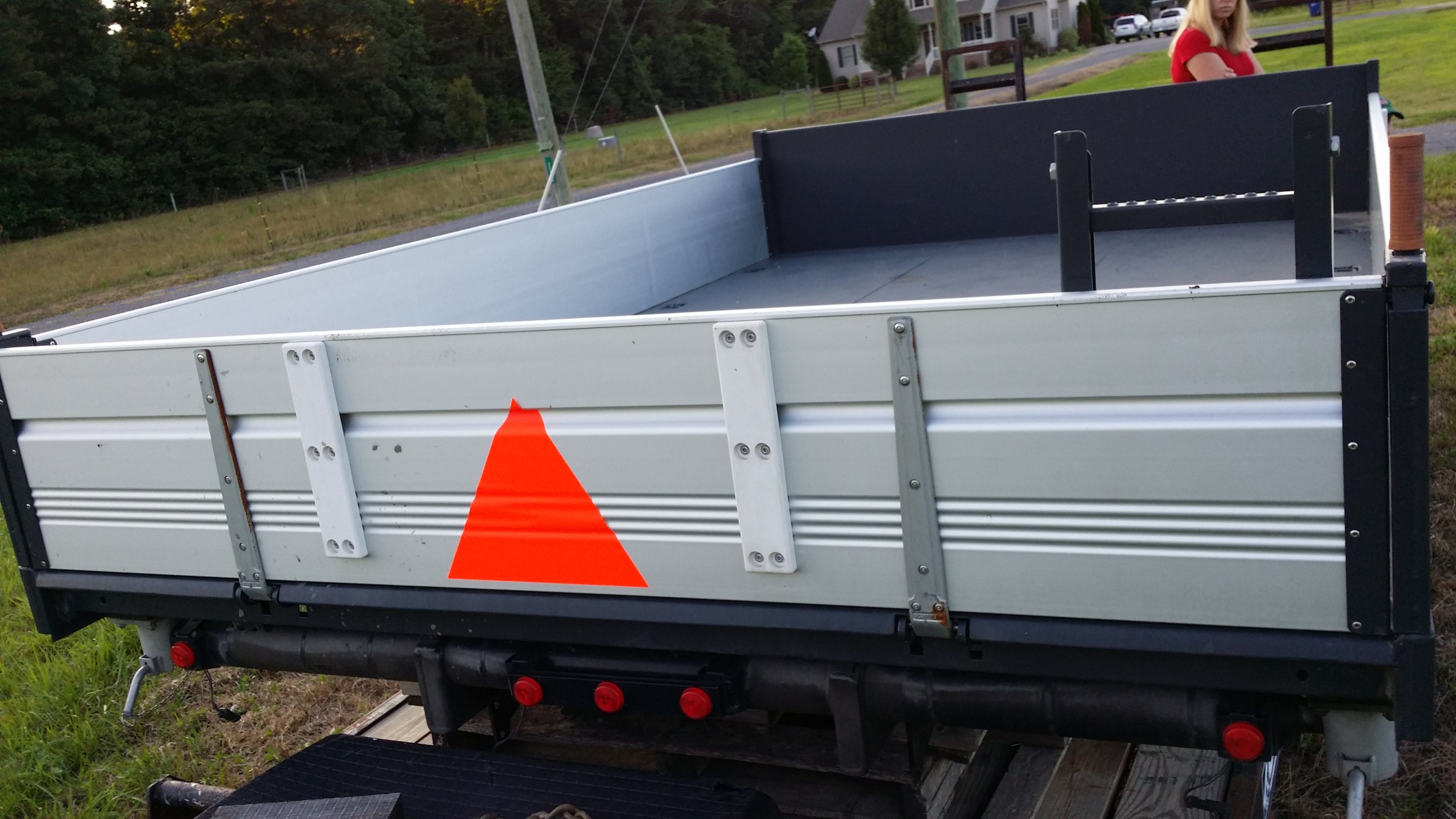

2003 Unimog U500, 33k GVW, 280 hp, 8 driving gears, 8 working gears, central tire inflation, includes 3-way tipper box, current body can removed from vehicle without damage to orginial chassis, extremely well cared for, everything operates as it should. 6900 original miles, original build cost was quoted at 320k. Max driving speed is governed at 70mph.

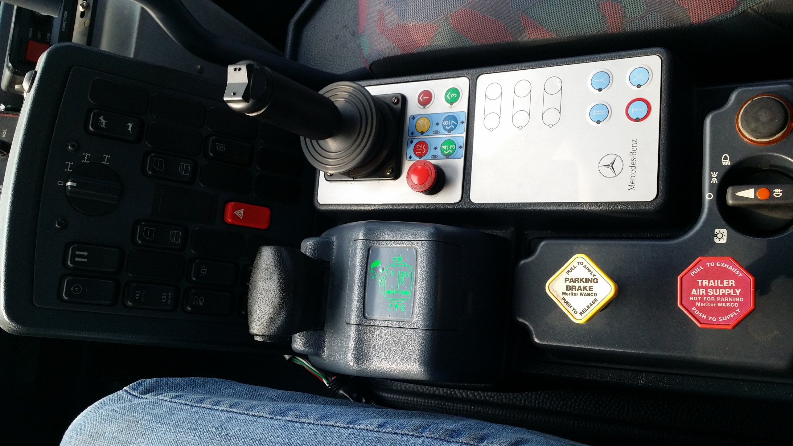

I went and checked out this truck today, very clean as you would expect for having 7000 miles.
If anyone can figure out how to convert the firetruck/service body into an expedition camper then it could be something really cool.
