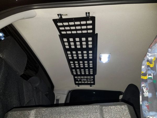

Ohh.. I'm interested.
Here's my 1st gen wishlist..
rs=w:600,h:600
Nice! I like that as well!
