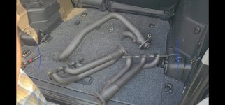

Sending the Wildcat headers to Jet Hot for their 2500 exterior/1300 interior coating. Just had the exhaust fabricated today from the crossover pipe back. Dual exhaust with Magnaflow mufflers. I'll upload a pic after I get home.

Piping from the headers to that temporary y-pipe will be fabricated after the headers come back from coating. The exhaust outlets will be adjusted and dressed up at that time as well. I'll get some pics of the completed exhaust while it's on the lift.

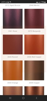

Alright... I need some help. Got my headers back from Jet-Hot for ceramic coating. Here's the color ordered (2036 Red Copper)...Screenshot_20250417_141744_DuckDuckGo.jpgScreenshot_20250417_141813_DuckDuckGo.jpg
...and here is the product received...
Jet-Hot is telling me the color in these pics looks the same to them. What about yall? Notice any difference? Like, I don't know, maybe it being a completely different color?
Seriously though, am I just not seeing this correctly?
Update... As frustrated as I was with the color issue, I gotta admit, Jet-Hot’s customer service was absolutely great. Sent them back to be recoated in a different color at no cost. Went with silver since there wasn't any option for red. Turn around time was a couple weeks. They look great!
