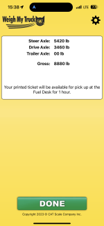

Something I am going to try to do at the end of each major phase of the build is weigh the truck. It's amazing how quickly stuff starts to add up, and I think it's important to have an idea of what each component weighs. This weight is basically completely stock - almost 9k lbs with full tanks leaves about 8500 lbs in payload left (17,500 GVWR). Should be plenty! I am estimating camper and subframe to weigh 3-4000.
