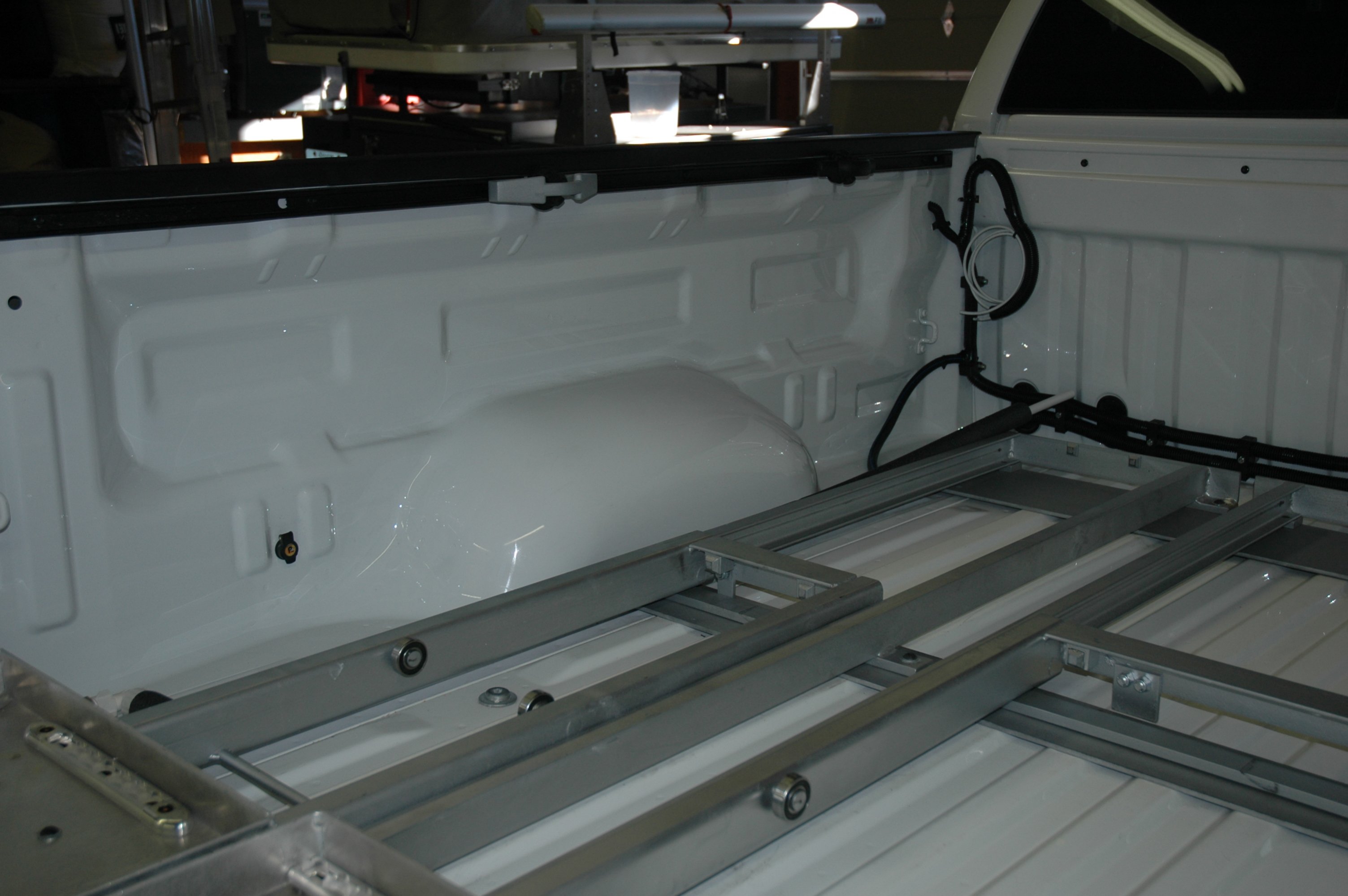

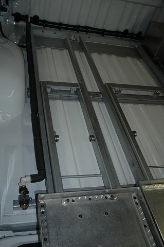

I have had several inquiries lately about removing the bed slides and whether there would be holes.
The bed slides are through bolted (via a custom flat bracket) to the frame using the existing bolts that hold the bed to the frame. To remove the slides they are simply unbolted from the bracket, removed, and the bracket unbolted from the bed/frame of the truck. No holes were cut in the installation. The process takes under an hour. Because there are two separate slides, the weight is distributed to two units making removal and installation easier/lighter than if there was a single slide.
cwvandy
Photos of bed slide attachment points.
