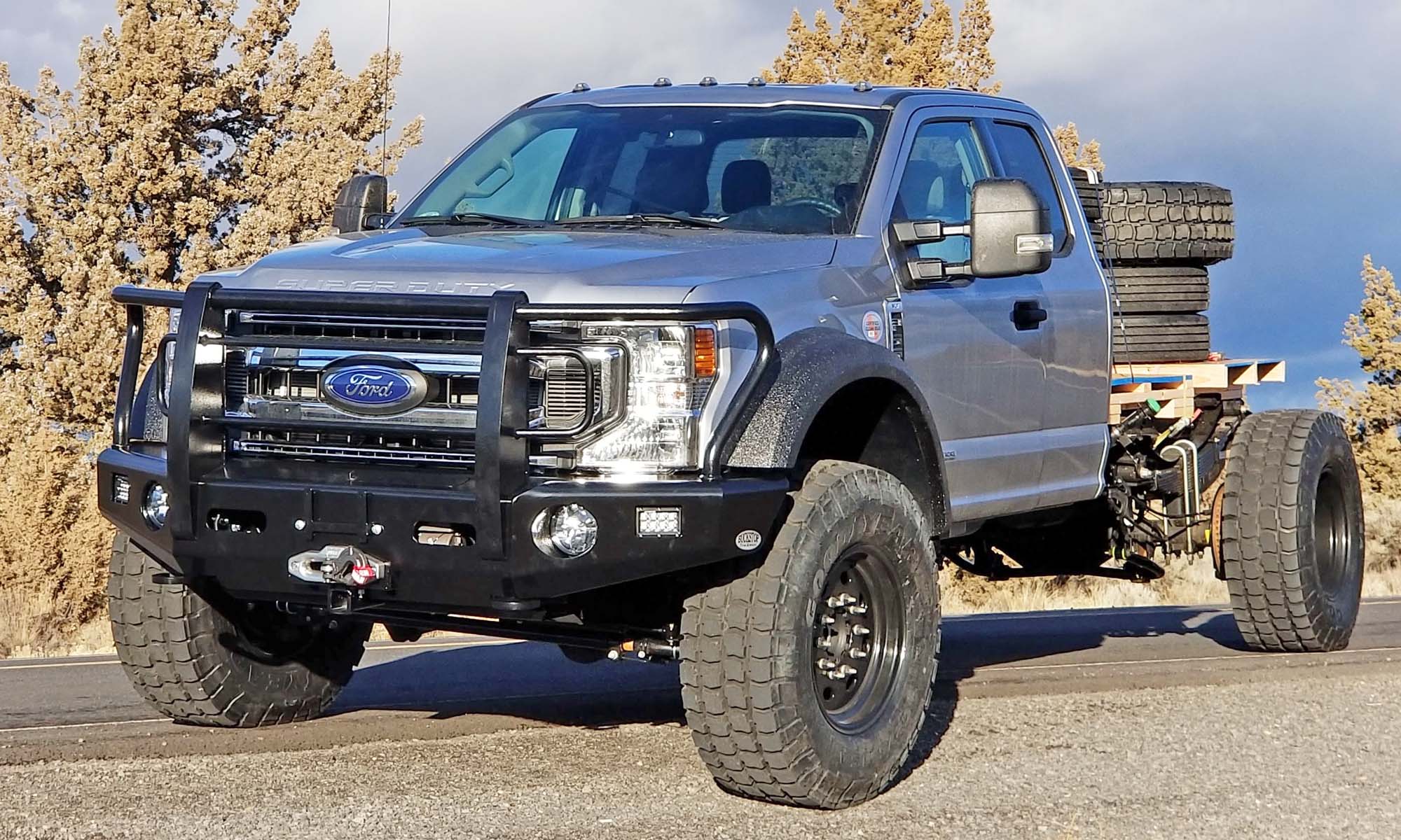

I purchased a low mileage Ford F550 CrewCab Lariat 203 wheelbase with 80" Cab to Axle which I pick up next week.
I actually was going to go after the Stewart & Stevenson LMTV then decided, after much research, that a Ram 5500 or Ford F-550 would be better for me.
The plan from here is to build out a capable class 'c' type of rig that will forge rivers in Alaska & Canada, hit the highways and byways in the Lower 48, and perform well off grid while still being classy enough to go to an RV Park/Campground (Barf).
I have done several years of research and I think I have alot of the build figured out but I will need help for sure and will reach out here for that. I will not spell out the plan, but I will post here with the steps that I think will take me a good part of a year +......
Please leave me your comments and ideas as I move ahead, I appreciate all feedback and links to similar builds....

`Truck is purchased and home now...
Next step is the first big purchase:
- Kelderman 4 link or Single link rear, still deciding. ( I did look at Liquid Springs, but the $17k, not including shipping, was the turn off for me)
- Kelderman single bags up front.
- Kelderman Compressor and air Dryer.
I will make the final decision on these within the week. No matter how I slice and dice it, I will need a 2.5-3 inch lift built into the system for more upcoming changes prior to building a habitat on the back. This is exactly why God created plasma cutters and welders.....
Either way step one is done, on to step two.... more to come...

As an update I have been working on getting parts in.
What I am finding when you orders wheels, bumpers, suspension, etc, pretty much anything for and F550 nothing is in stock, it is all made once ordered. Granted some of the stuff still on the way is special ordered.
1 - Either way, I have done a lot of misc work on the interior like replacing scratched pieces, shampooing carpet and headliner, etc.... Mechanically All fluids and filters have been changed so I now have a baseline of when to change fluids and filters as I roll forward. I don't think the cabin air filter was ever changed. The radiator is flushed, tranny changed with filter, axles, transfer case, fuel filers, yada yada yada.
2 - I got into the engine bay and replaced to cold air pipe with Sinister Deisel's upgrade, defiantly will not have to worry about that pipe. Also bought their battery tiedowns since mine were rusted.
3 - I hate chrome so I replaced the chrome grill with the factory black, I like it... My front black bumper is ordered and will be here some time in the next 4 weeks once built. I was going to make my own but found one close to what I was going to do and ended up getting a great price on it.
4 - I took off the factory running boards, sold them in a day, and installed the Amp Research Extreme boards with two motors per side and the LED lights. Way better, and comes down significantly lower than the factory boards. When they are up the sides of the truck look so much cleaner. The only issue with the install was that the wiring harness is not long enough for the led lights on each side so I had to splice in extra wire so the lights would reach the right spots under the body... Amp Research Part # AMP-78235-01A. I also installed the OBDII splitter so that I don't have to worry about ever unplugging the running boards from the OBDII, came out clean. The splitter screw holes do not match up to factory holes under the dash so I made an adapter which came out very clean and looks factory, the rest of the harness I zipped way up by the instrument cluster where it won't rattle and is out of the way of everything. Splitter: https://www.summitracing.com/parts/...LH5gHNLBuezyyG6vB5G-2cGBXiH-NktxoCKjMQAvD_BwE
5 - Purchased the auto agent with unlimited tunes. Love this thing, I can get any tune I need and get diagnosed remotely by mechanics and so much more.. Very cool...
6 - Picked up 4 of Rigids D-series lights for my pending bumper. I know I will eventually add more lights but I want to get more 'things' installed on the truck before I make more decisions on lighting. The new bumper has a spot for 4 lights so this decision was easy.
7 - I went with f150leds.com led bulbs and swapped them, way better than stock headlight bulbs...
https://www.f150leds.com/?gclid=Cjw...CxbEhLuLtN3o1dz6x60IJALIFpEPTtLhoCcjgQAvD_BwE
I do need help making a decision on front fender flares. As stated, I will have the Kelderman airbags with 2.5 lift up front. I need to do the standard surgery on the fender and wheel well no matter what fender flare I get.
I am looking at:
- DBL Designs Generation 1, its simple too me. Gen 2 & 3 take away from the front factory look which I like. Gen 1 is just plain and simple. BuckStop is great looking and comes with everything to do the surgery on the wheel well, $1,600 and there is a 3-5 month backlog. Lastly, Fabfour looks good but in my NOVICE opinion the surgery required for these is way overboard. I also don't think it will cover my tires well. My last option is making my own out of 1 ½ DOM, ¼ wall tube with 14 gauge steel plate, then have the rhino lined, kinda like the old Jeeper style tube fenders...Any other options out there I an missing. The goal is minimal to no lift to fit the 335/80R20 tires. Either way I will have to disassemble the entire front and, conduct surgery and put it back together again to attain this..
Gen 1
FabFours
ford-super-duty-open-fender-system-fender-flare
BuckStop
So what's next, I'm picking up 5 GoodYear G275 335/80R20's this week. Wheels are getting shipped to me next week, more to come on which wheels I purchased on my next post..
