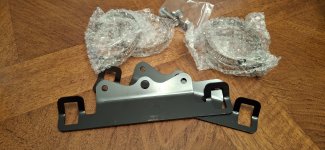

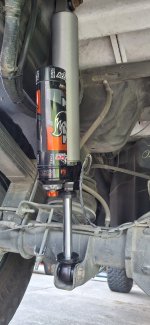

I used these:
Fox Shox 803-02-042-Universal Reservoir Mounting Bracket​
Used center hole so self aligning, drilled into top of the spring bracket, bolted on rather than welded. Yes red loctite on nut.
30,000 miles, so far so good.
modified caps from spray can lids to keep the worst of mud from getting into the adjusters on the front shocks. Yes drain holes on the bottom.
30,000 miles, still there.

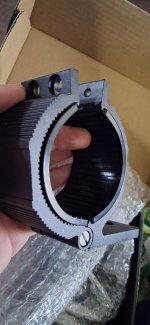

Rock guards where made by splitting some of this:
Once split and relaxed they are a mild snap fit around the body. Shape to suit and attach with band clamps (I have two so the spare is where I can find it).

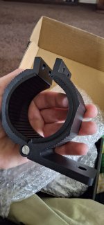

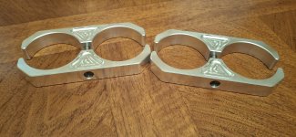

I've also gotten 2 of the 3 ideas I've looked at in today. Was next day shipping from last night. I have one more coming, and I can try all 3, then decide. Funny enough, one of them was your exact mount. The third is a billet aluminum reservoir to body clamp. It should be in Wednesday.
Yep, you got it covered!
That first clamp looks the business, bet the aluminum one will be ligit as well.
Enjoy the new complianice, definitely better on ours.
Yes it's much more beefy than I thought from the pictures. I just wish it had more than a single bolt hole, but that can be fixed if needed.
I'm super excited to feel out the shock compliance and stability. But anything has to be better than these stock 6yr old AEV Bilstein 5100's. 🤭
Got the billet mounts in, just waiting on the boots now. Ended up going with the boot Accutune suggested, since they are the ones that warranty the shocks. I'd rather not have the shaft pits from my own neglect. Then I can finally get this all in.
Still unsure which of the three mount options I'll use, but I'll fit each option up once the boots are here.

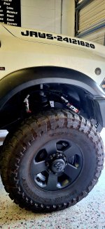

It's mid May, and the front shocks are on, so I'm holding to schedule. We head out for vacation next week, so I'm buttoning up all the last few things. Needed to adjust the 4x4 shift lever since it came loose on my last outing. Needed to rotate the tires, and got the shocks on. This weekend I'll clean her up and take the truck and trailer for it's first ride since changing a TON of little things on both.

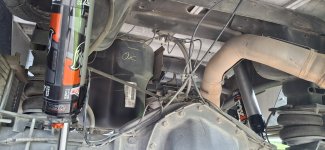

Got two pretty big things crossed off the list before we leave. When I got the shocks above on, I noticed with the airbags bolted to both the frame and axle, I wasn't using all the extension of the 12" rear shocks. These cradles will give me the support I need and give me back that additional 4.5" of droop extension. I'm embarrassed it took this long to put them in, I've had them a LONG time. Lol

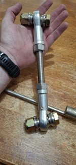

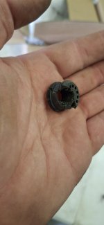

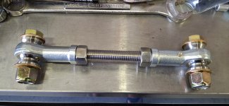

Then tackled this way under engineered 4x4 shifter. I've worn out these bushings twice, I wasn't replacing them a 3rd time. This will NOT fail, which is what I want. And, 5/8" fits the avaliable hole size perfectly on both the shifter arm and the transfer case mechanism.
