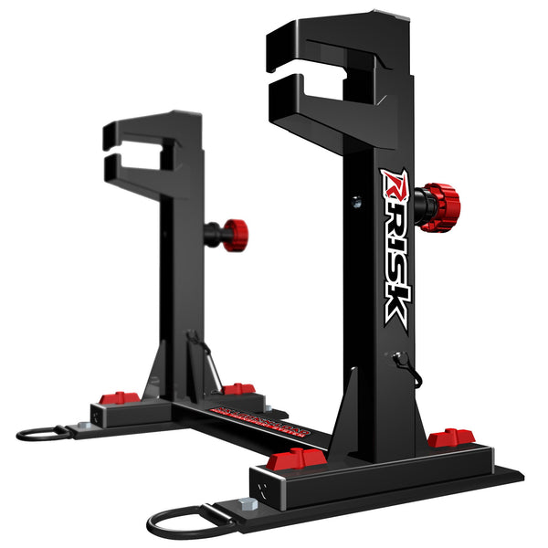

I like that much more than the lock and load system risk uses. Tried the LAL on on of my trailers but it was a pita to try and work with.
