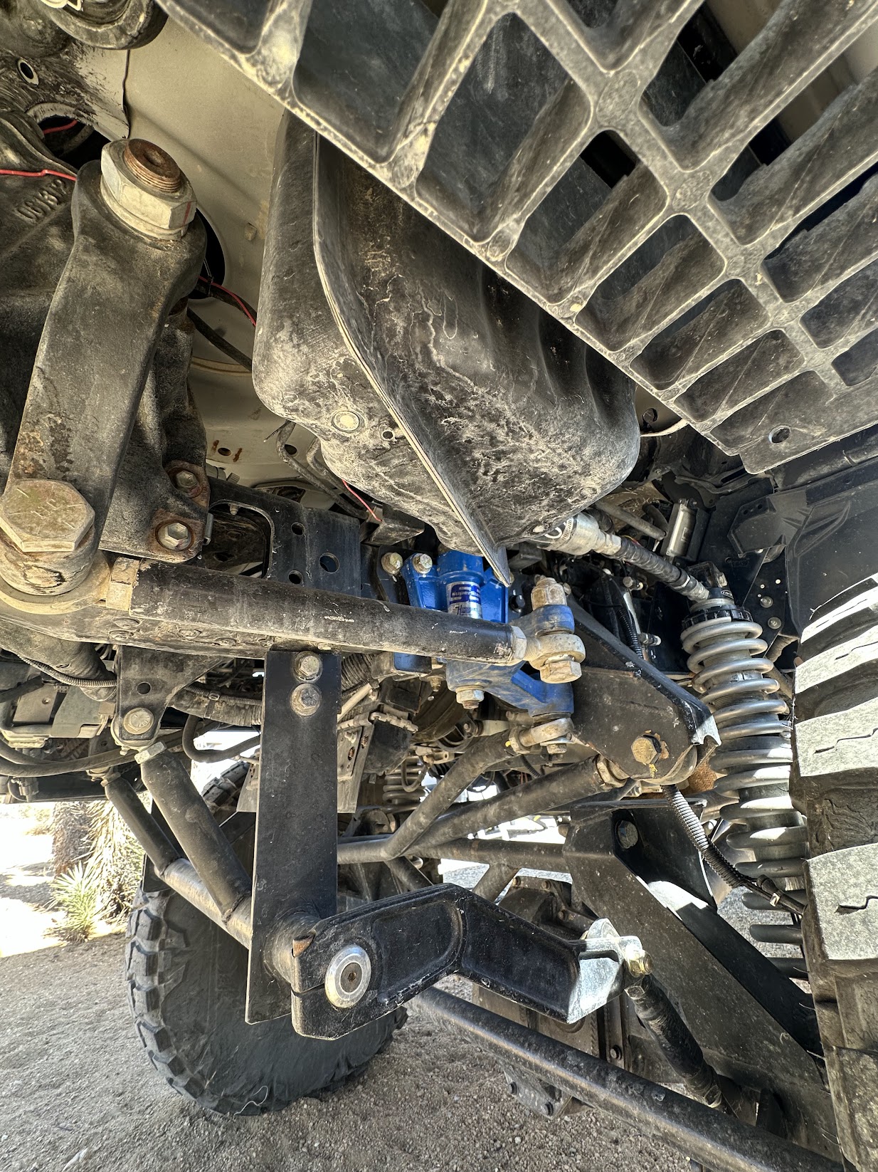

Can you add some pictures of how you did the steering on your dana 60 conversion? Is it push/pull or crossover?
Needs a wash but you get the idea. It's using a super steer, I have a ramsteer just haven't bothered putting it on. The issue I have with the steering is it gives you almost no room for a sway.

Awesome, thanks. How does it feel going down the road?
