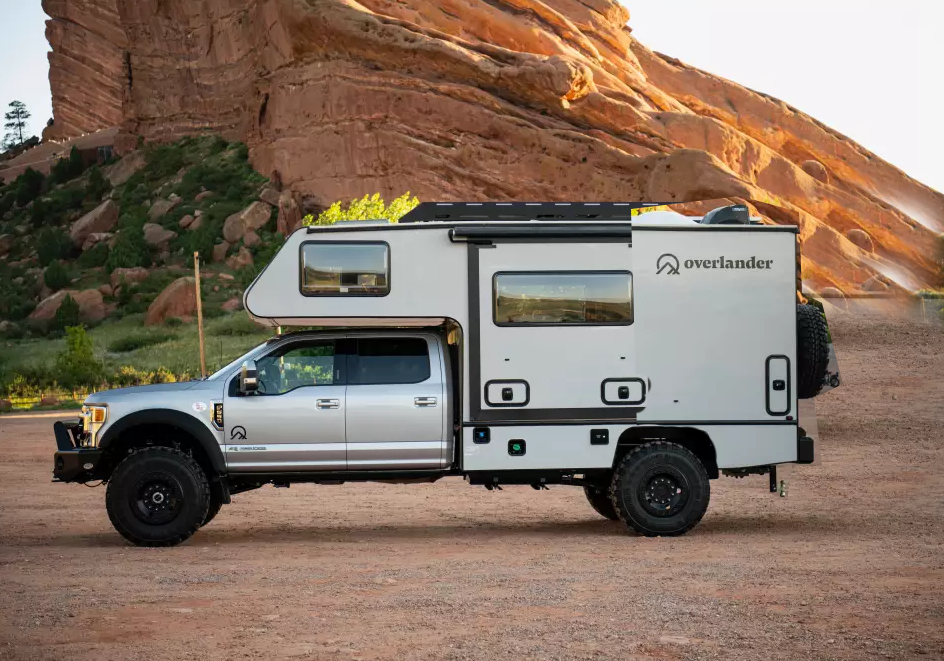

2021 Adventure Overlander F550 4x4 "Expedition" vehicle
Having owned f series big RVs on military tires for almost 15 years, including same as above.I can say the departure angle is definitely not the limiting factor.
Really... you never drive on trails where this departure angle would be a problem? Also, it looks like typical RV habitat construction.
The frame can't handle weight loads and often is at the limit or worse. The frame cannot twist enough to keep all four wheels on the ground when driving over roads with erosion and especially up hill.

They were never sold new, but as rrexerr said, Fraserway is selling several used ones for around $150k USD.
That's not true. You are confusing two nearly identical models built by AMLRV:
1. The AMLRV Overlander - as in this post. Built for sale to individuals, new. Off-road bumpers front and back, available from the factory with super-single rear tires, upgraded solar, and improved dometic-style windows throughout. In later years they were also made with a shorter habitat on the back to improve departure angles. The shorter habitat (2' shorter), resulted in the bathroom being converted to a wet bath.
2. The AMLRV Adventurer Quad - Built for the RV rental market. This is the one you are referring to. All of the upgrades I mentioned above were not on this model, and as far as I know, they did not offer a shorter habitat/wet-bath option. Dually rear wheels only. Otherwise this unit is identical.
I am sure there are other differences that I am missing, but that's the gist of it.
The overlander was sold in much smaller quantities and is harder to find. The Adventurer Quad was made in higher numbers, and easier to find than the Overlander, but as they were also stopped being built circa 2021, they aren't easy to find either.
This one was a rental for a short period I believe, it’s an Overlander.
