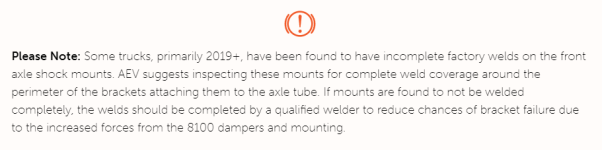

I've said this before, and I'll say it again, the AEV suspension is not the best bet for these trucks. If your goal is to run 37s max, then you don't need to lift 3" front and 2" rear with the stock coils/leafs, you just don't have enough travel on those to justify needing any extra height. You can run 37s on the stock suspension with the proper wheel offset and a tiny amount of trimming.

As far as the front lower shock mount, it is an issue, but not 100% guaranteed to fail. Really depends on how much you're getting after it at speed and weight. Carli sells a lower shock mount replacement that you cut your OEM out and weld these in (link) and Thuren sells a support that you attach via welds while keeping the OEM (link). Both are valid options, pick your poison.
