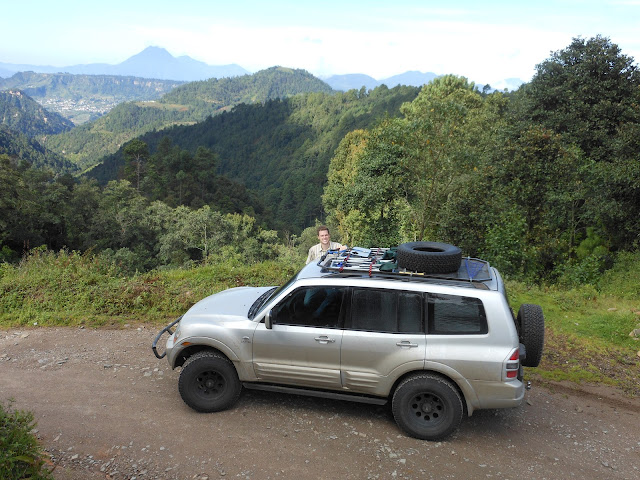

I checked the deflection of the OEM load bars with that big spare, two full cans of gas AND the high-lift jack...nothing. Then I climbed up there myself. There was some deflection of the roof...just a bit, but the load bars themselves didn't flex. After 3,000 miles of the above heavy loading (obviously more than that cheap aluminum rack was ever meant for) on some really jolting terrain in Moab, the aluminum rack has started to really show wear but the Mitsu's own load bars and roof are perfectly fine.

There isn't much to it honestly. It's 1/2" square tubbing with expanded metal and a few u-bolts to the standard roof rack. We threw it together in an afternoon. It's been working great however. We carry a tire, 10 gallons of water, 5 gallons of gas and a couple camp chairs up there. I left a big opening for the sunroof. I like the low profile look and everything gets strapped/bolted down anyway so there was no point in welding on big ugly sides.

btw, how well did the elastic netting work to hold the water? in my experience they allow all sorts of things to escape. Even the tops of storage!! I almost always recommend ditching them for ratcheting straps instead.
It's worked fine so far (7k miles, 8 countries.) It was one of those many things that on the day of departure I realized I hadn't figured out. So I grabbed it from the box of old motorcycle gear (used to carry my bag on the backseat of my CBR for about a year). I keep thinking I'll replace it but it's nice to be able to pull a tank down quickly.
