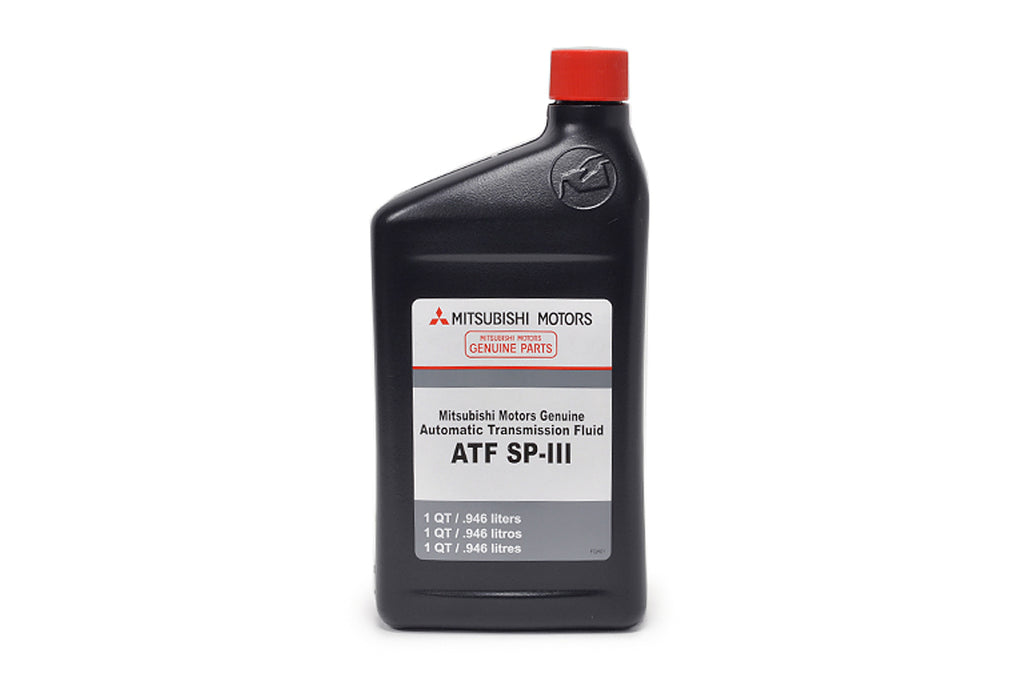

I have a 2006 Montero Limited with 175,000 miles, but I’m not sure when the transmission was last serviced. I’m considering a drain and refill with Mitsubishi SPIII ATF, but I’ve heard mixed advice—some say there’s a risk of transmission failure after a fluid change with high mileage. Currently, the fluid still looks pinkish-red and doesn’t smell burnt, and I haven’t noticed any shifting issues or shuddering. I’ve watched videos where some people advise against changing it, while others say it’s fine. I want to keep up with maintenance but feel hesitant about this one. Any thoughts, suggestions, or personal experiences, good or bad?

Complete a full fluid exchange with SP3. The procedure is relatively simple. Drain and refill the pan.
Remove the ATF line that feeds the cooler. Cycle the ignition (briefly) so some fluid is pumped out of the line. Replace through the dipstick. Continue brief cycling of ignition until fresh fluid is being pumped out. You'll need about 12 quarts of fluid to do a complete flush. Remember to check the level with the engine at temp., after cycling it through all the gears, then check while running in N.

I used this mob linked below as a supplier:

I just completed a drain and fill, draining about 6 quarts from the pan and refilling with SP3 ATF. The transmission shifts smoothly with no issues. I’m planning to do another drain and fill in 10-15k miles.
