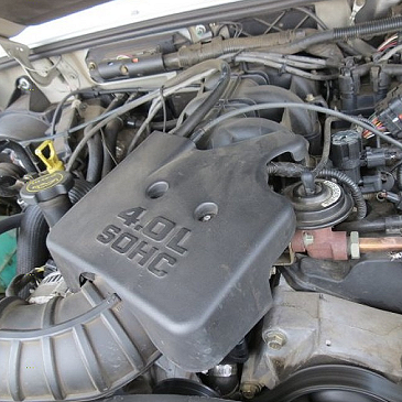

Timing chain tensioners are the issue with the SOHC 4.0. Requires removal of the engine to repair, if left to go too long they can cause piston/valve interference. Once you get past that they are a good engine. They get scarce the newer you go but I would rather have the 3.0.

It will sound like change rattling around in a can on a cold start when it begins. When it is advanced, it will be on every start. Definitely get repaired asap if it is every start.
