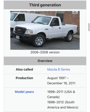

Thanks guys. Just for clarification, I am looking for something in the 2000-2011 range. I thought that was the 3rd gen (according to wiki anyway).

Wikipedia has been a great annoyance to the Ranger community with their strange generation scheme...
