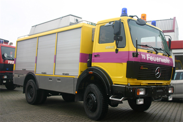

I sent my truck to XP a couple of weeks ago now. Marc has been laying out a basic design but has only now be able to finalize a design. We are hoping to have it done by Overland Expo in May, so about 8 or so months. But you have to remember everything is done custom for my truck and my interior needs.
Cost is $550 per sqr ft for basic setup.

So a little update.
We are building the subframe and storage boxes.
We are installing an Onan diesel generator. Still trying to figure out if I want the 27 or 50 amp. I think the 27 would be fine if we ran the A/C but would have to turn it off to use the microwave. but the 50 is super overkill. Thoughts? Both sizes use less than .5gal of fuel per hour (27amp .3gal, 50amp .4gal).
I was hoping to go full DC on the truck but the amount of power we would need (A/C, fridge, TV, microwave...) would mean many batteries. So I figured an AC A/C was cheaper and easier to service, no need for an inverter. Take the two big power hogs the A/C (15amps) and the microwave (13amps) and that leaves a reasonable amount of DC power needed.
