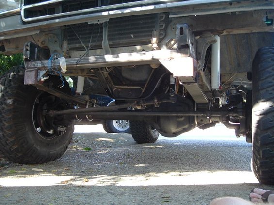

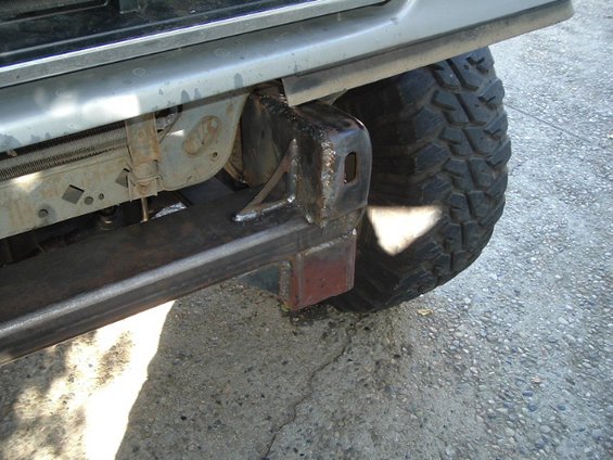

also, if you are handy with a welder and grinder, you can make your own shackle reversal kit in a couple hours from 2x4 and 4x4 box tube:
I swapped a solid axle into the front of my Bronco, and basically made it an F350. I used the factory spring hangers near the cab mount, F350 springs and steering, and shackles from rear Bronco springs. I swapped around a few springs in there over the years, but finally ended up on some lift springs from the back of a K5 Blazer (they share the same overall length and eye to eye dimensions). The 2 leaf front setup is dumb, you want a nice progressive 5+ leaf pack like pappawheely suggested. And I can't stress the importance of just having a GOOD shock on there!
