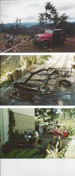

Scout II Saginaw box, Scout II P/S lines, 81 Toyota pickup TRE, 70 Bel Air pitman arm…. All bolt together. The pitman arm was carefully heated and reshaped following the instructions of a very experienced welder & cruiser owner. Ford shock towers will be used to clear the box and Flaming River shaft & U-joints.

It has been a project since 1991.
Here’s a link to its thread:
