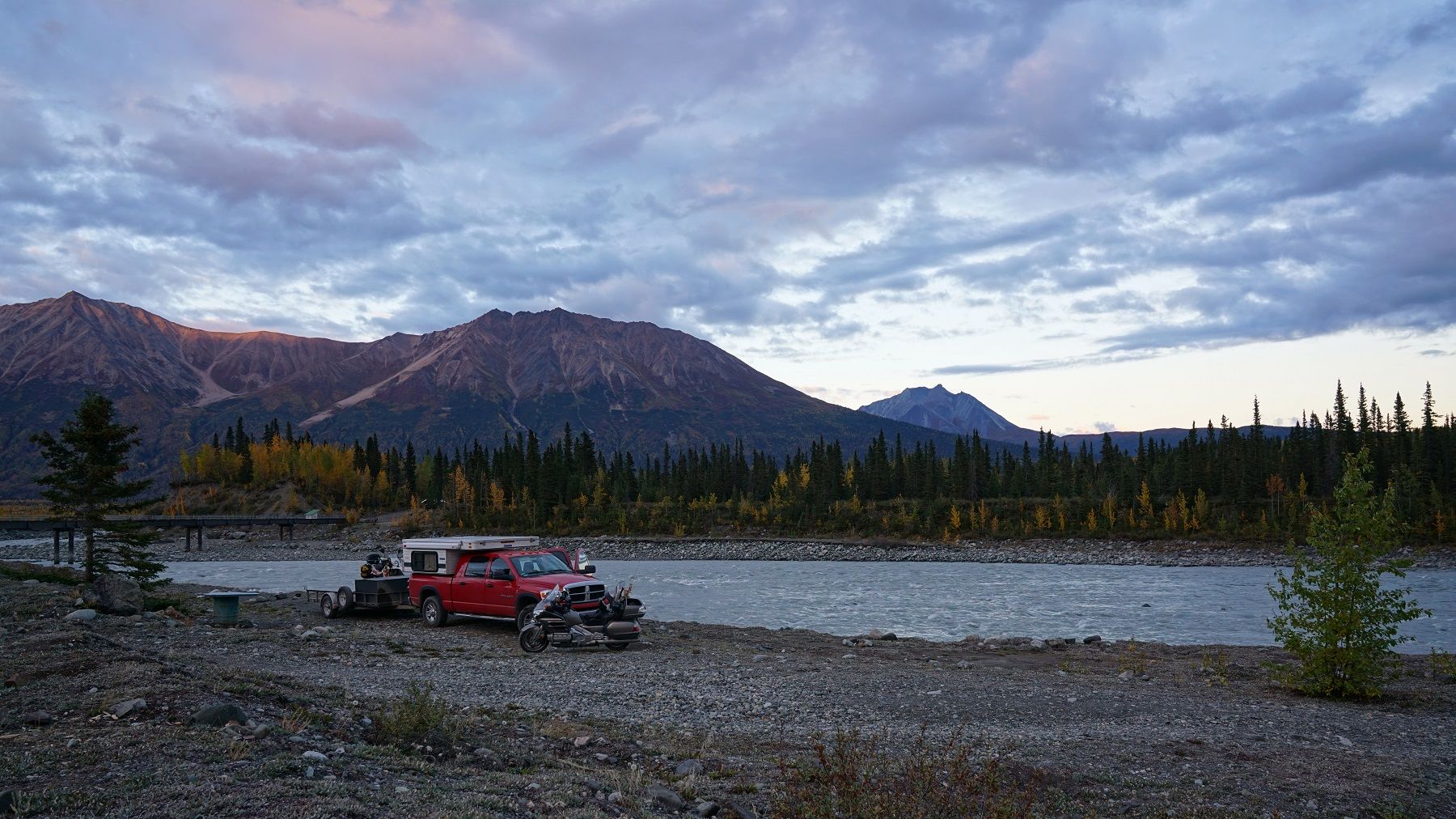

@sg1, Had rain 5 of 30 days, never hard. We were very blessed. No skeeters either :). We traveled from Aug 18 to Sept 18 in hopes of less rain, bugs, and tourists. I was on whichever bike was appropriate and Dad was chasing in truck.

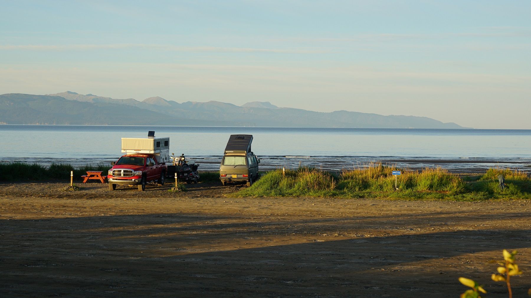

Homer Spit

McCarthy

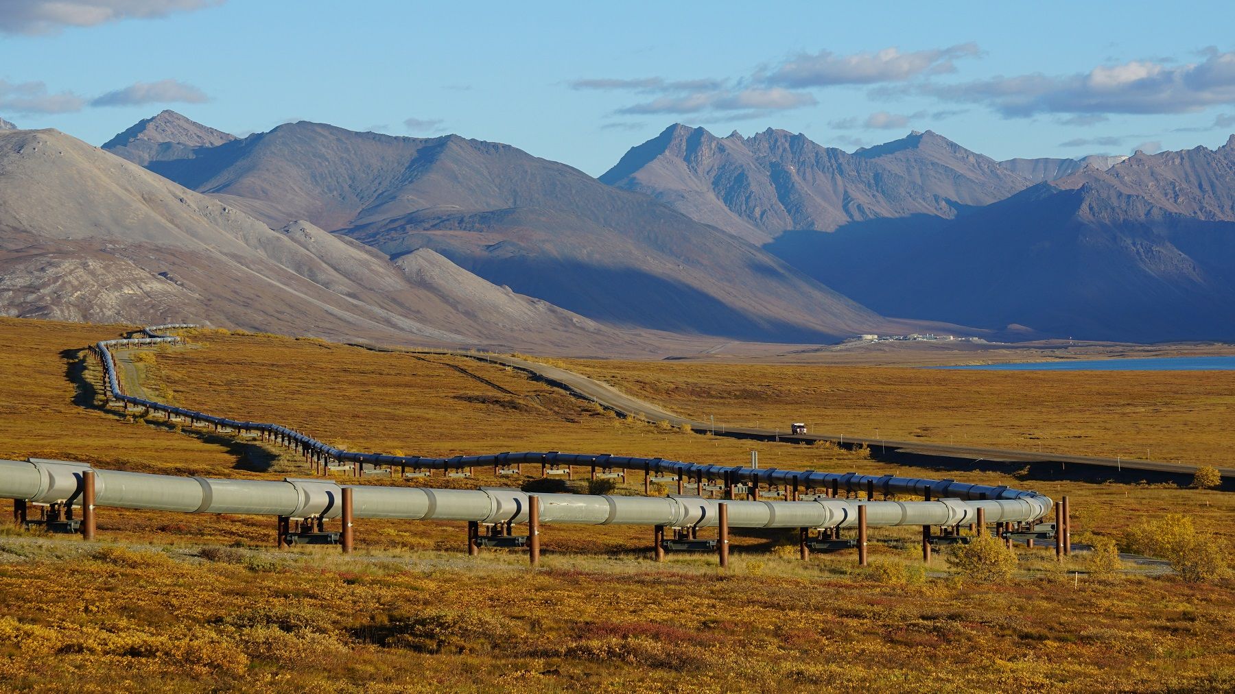

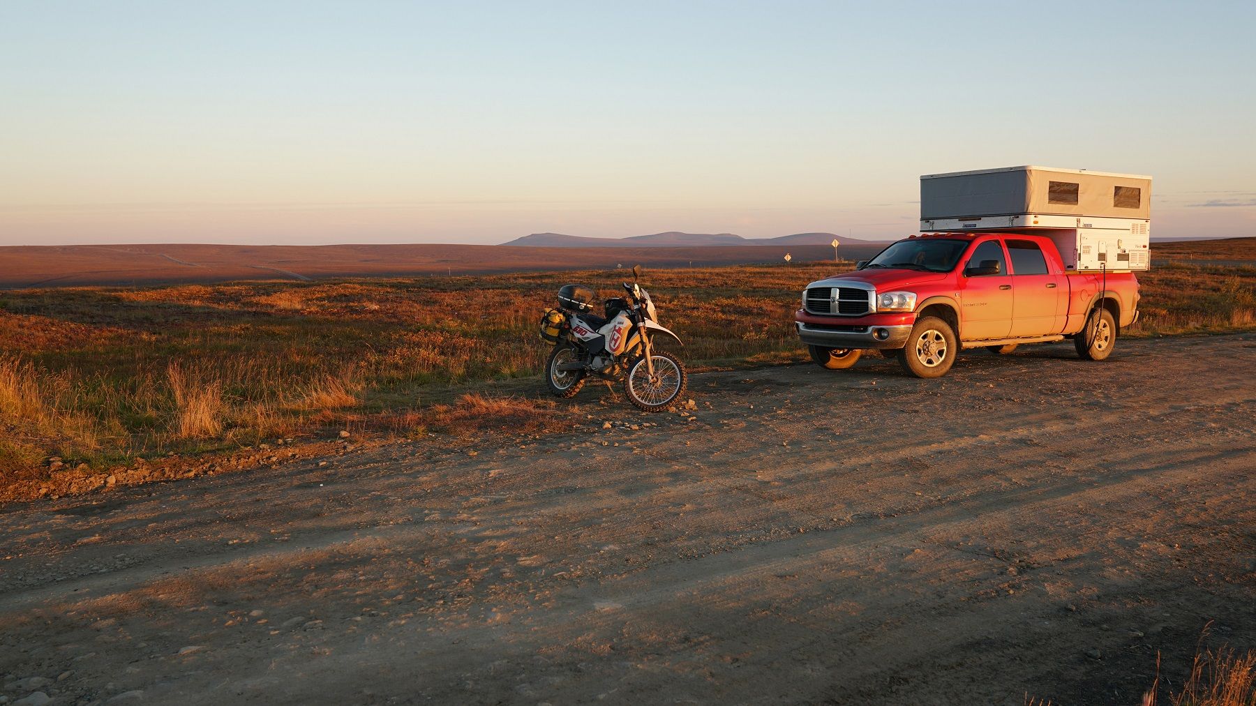

Dalton Hwy, we camped on the North Slope 100mi from Prudhoe
