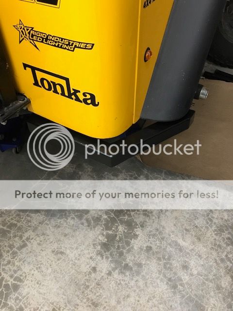

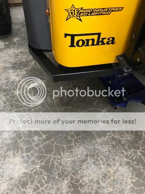

I was finally able to spend some time out in the shop this weekend and was able to get the rock rail style protection done on the front edge of the tub. They are bolted to the frame and aren't perfect by any means. They aren't perfectly level or straight but that's fine, just don't look at them too closely, they should do the job just fine :). I had to order more tubing and it should be here by the weekend, then I'll work on the back corner ones as well as a bumper of sorts for the back edge.
