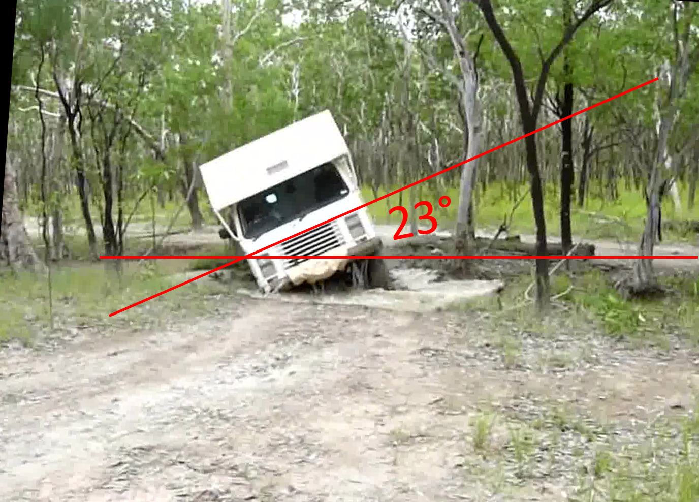

This rig weighs about 6 to 6.5T.
Wow, that's impressive!! :0
I was curious, so I measured the worst frame of your video. Looking at the trees, the camera seems to be tilted about 4°. After compensating for that, I measure 23°. I'm surprised how scary 23° looks!
rruff
We usually pucker up and freak out when we get about half way to the tipping point. Because he's bouncing, he's probably over half way.
To clarify, in a static situation the CG needs to tilt past the tire contact point that you'll be pivoting on when you tip over. For instance, say his CG is in the center of his rig, and at the level of the top of the radiator where you drew the line. If you draw a vertical line through the tire contact with the ground, he's still a long way from that point. And his actual CG is probably quite a bit lower.
