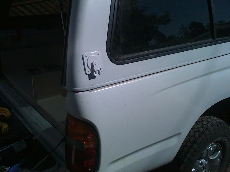

Perhaps something like what the older Stockland bed shells had?
Note the little scoop forward of the side window on the shell. They have a single stud through the shell wall that allowed any orientation, and on the inside was a small piece of rectangular fiberglass that could be rotated to open or close the port holes.

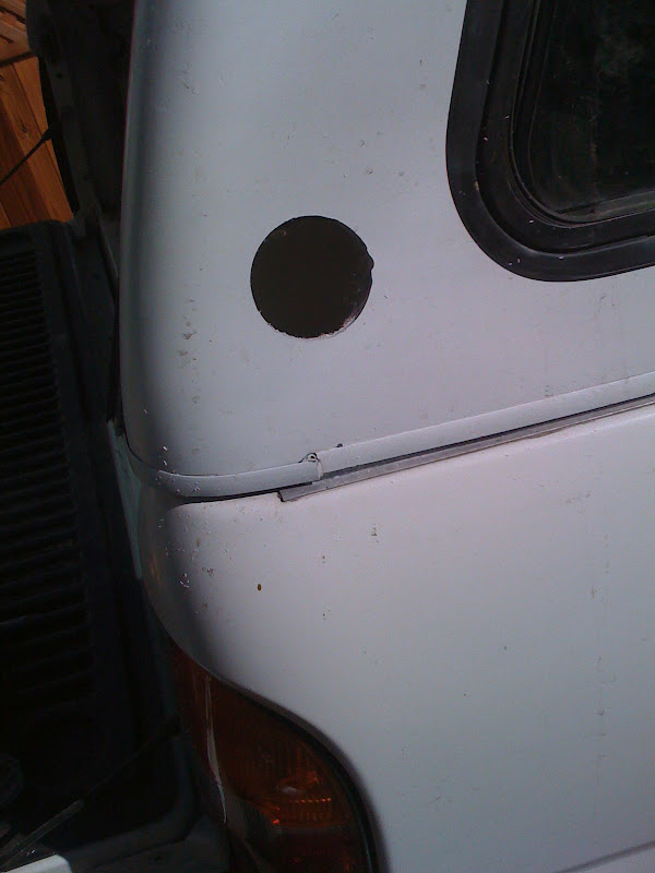

How to make a hole- just get the proper sized hole saw, a dust mask, and drill away! The irregularity in this circle was due to my squirrely attempt to enlarge the hole by 1/16" using a dremel.
