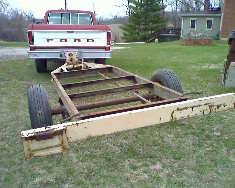

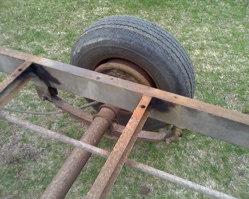

I went for a look today, franky the condition was better than I expected, but it was heavier/larger than I thought as well. It seems to be well made.
It was made to carry a full 8' ford pickup bed, is a full 12' from bumper to lunette, 7 3/4 feet long at the bed, and is 3 1/2 feet wide. The axle is 4 1/2 feet and 3.5" in diameter. The lunette is 22 inches high, so that would have to be changed. The stamp on the bed says it's #1200 empty with an #1800 capacity. I assume the bed was probably 3-400 pounds, so that makes the trailer about 800 pounds as is.
on the good side, its got a parking brake, is pretty much rust free, has the same bolt pattern as the wheels on the Trooper, and has a clearance of 16" at the frame.
the downside is weight (I think- is this a good weight??), the fact I would want to shorten the frame by a couple of feet, and I may need to redo the lunette and lower it down.
I guess the question now is, is this a good start for a budget build?
Here's a few pics, I'd like some educated opinions, thanks!
Titanpat57
It looks built like a brick ******** house...I'd say SCORE!!
Do you want to do just a tub trailer, do you want to do an enclosed with tent on top, do you need something that's multi-purpose? I'd say minimum loose the back bumper, cut a bunch of steel off the tongue, and do a SOA.
Write down the needs v. wants x budget...see what you come up with!!!
Good Luck, Pat:victory:
