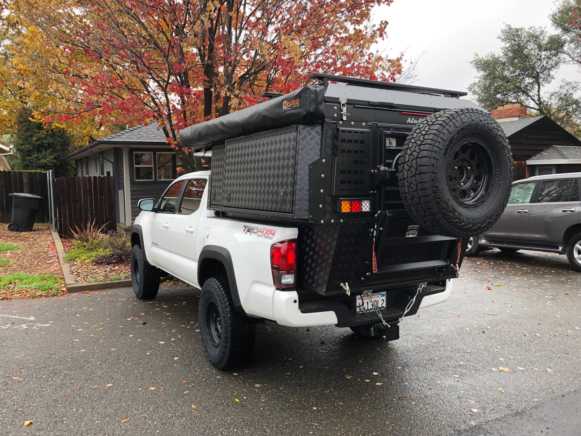

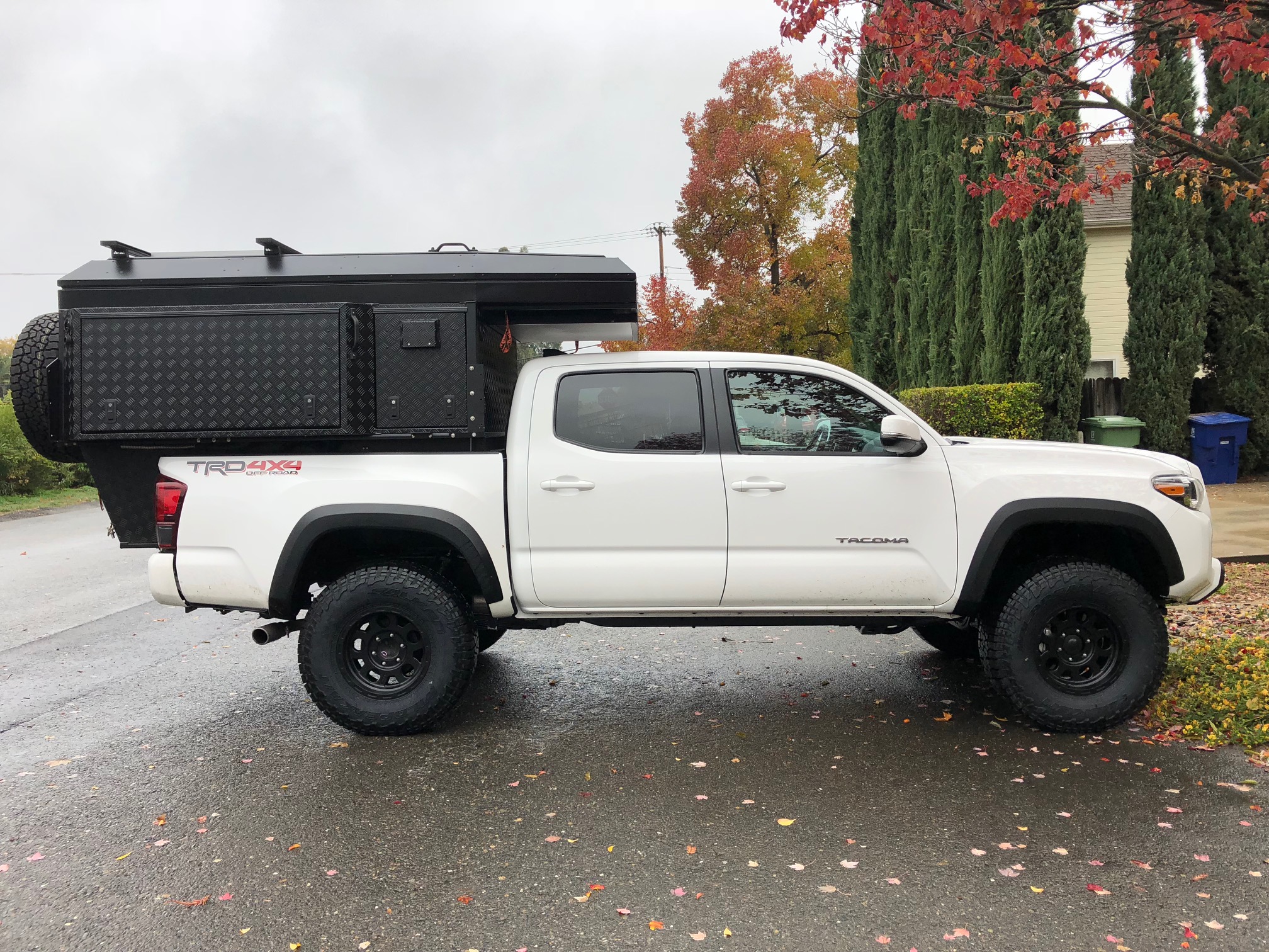

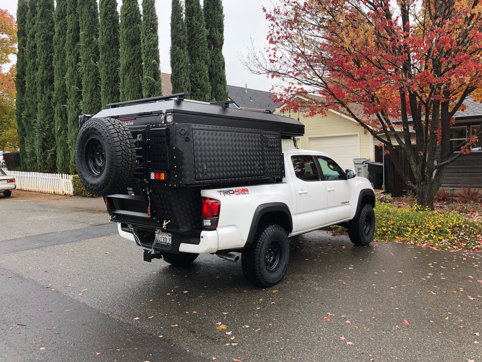

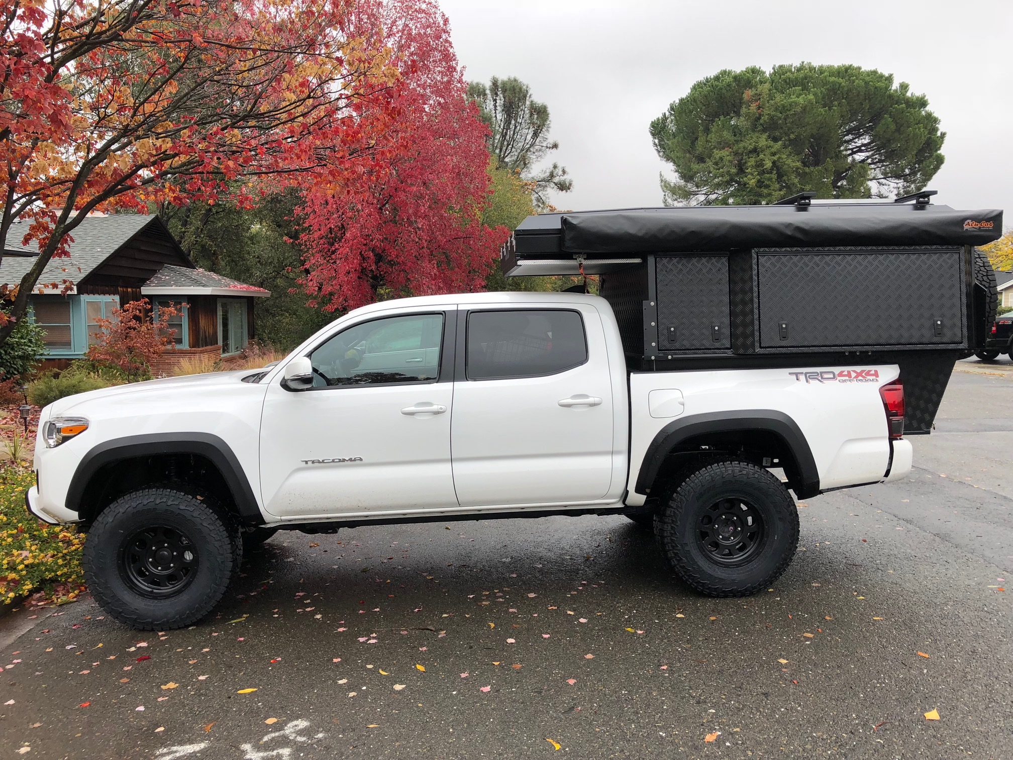

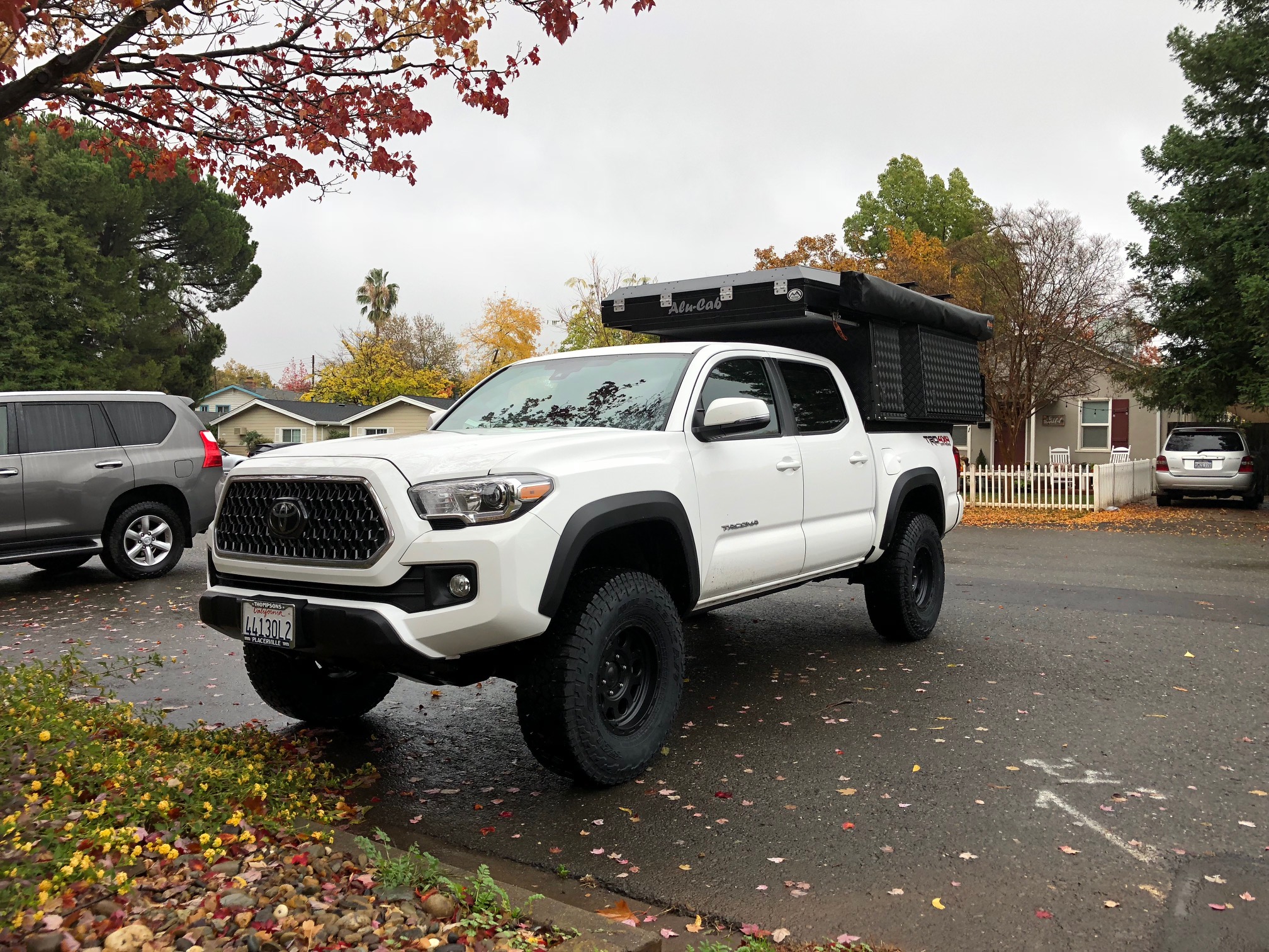

Finally got around to getting suspension and wheels/tires on our demo unit. I've heard of a few Khaya owners who have just done air bags with stock suspension...but going with a real suspension upgrade is a must in our opinion. This is an OME heavy kit (OMETAC16HKSB - $1,225) with a 1" spacer under the rear 96 series springs with the OEM UCA's in the front. It leveled out the truck perfectly and clears 285/75/16 tires no problem.
View attachment 485681View attachment 485682View attachment 485683View attachment 485684View attachment 485685

These campers if fully loaded definitely max the payload of a Tacoma...Upgrading the suspension just makes it handle safer...does not change the payload max
