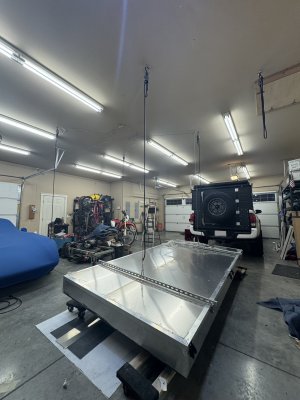

Roof Weight
The roof is now finished and skinned in 0.040 aluminum, but I'm really surprised at how heavy it is. It comes in at roughly 100 lbs which is about 1.6 lbs per square foot. I suppose that isn't awful considering that not only does it have to provide cover from the elements, but also be strong enough to withstand pulling up the entire weight of the walls from very concentrated load points. Not really sure where I could shave weight, because there isn't much to it (as you may have seen from previous posts). My calculations showed that going with 0.030 aluminum skin wouldn't have really saved all that much weight and I wanted the roof to have a fair amount of impact resistance from branches and hail and stuff. If anyone has any pointers on how I might build it lighter (without having to go the fiber and epoxy route) would love to hear it!
Gas Struts
The gas struts I'm currently using are rated at 40lbs each which are more than plenty to push up 100 lbs of roof, but only when they get past a certain point. Since the gas struts are mostly providing force in the horizontal axis when the roof is folded, it takes an immense amount of effort (almost 100 lbs worth of effort) to get the roof pushed up to 12-18 inches. Beyond that, the struts provide more than enough force to lift the roof the rest of the way on their own as they start to exert more force in the vertical direction.
There are two obvious solutions here: 1) get stronger struts or 2) make a lighter roof. Well #2 is out for now since I'm not fully sure how I can make it lighter at this point, so that leaves us #1. But there are a few problems with going with stronger struts.
1. Once the roof is in the up position, it actually takes a reasonable effort (at least it's reasonable) to get it back down again since the struts are now pushing upwards with 160 lbs for a 100 lb roof. Stronger struts might turn this reasonable effort into unreasonable effort.
2. In the up position, if the struts are pushing up with much greater force than the weight of the roof, it results in a lot of pent up and useless force on the hinges and attachment points for long periods of time. These are highly concentrated structural points that I would prefer to only be under stress during the short period of time while the roof is opening or closing. When the roof is opened or closed, preferably the force would be distributed over a large surface area, like the the walls and the frame, not the strut and hinge attachment points. In a perfect world we could just make sure that the struts are at the end of their travel by the time the roof is fully extended, but that won't work. Due to the nature of how it folds— the roof goes slightly higher just before it's fully up, when it settles down an inch or so again.
In a perfect world we'd have struts that provide equal force in the vertical direction at all times and size them according to the weight of the roof and walls, but that's not really an option here. I've thought about a scissor jack type of arrangement, but any ideas I have there are too bulky, so I'm not fully sure what I'm going to do here and would love some suggestions. As of now, I've just decided that I'm going to live with having to struggle to push it up in the beginning while I work out a longer-term solution.

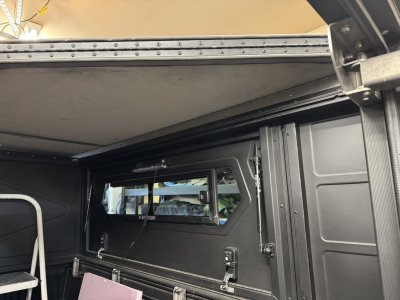

Possible Death Trap?

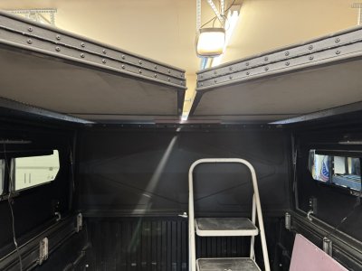

This is one of those things that unlocks a new fear of death that you never knew existed before :D. This hard folding wall design— and not just my design, but I think any others out there who are using a similar folding method, Hiatus, etc.— could potentially be a guillotine. Let me explain.
To get the maximum amount of height possible, the walls will end up being roughly half of the width of the camper when folded down. So imagine the walls start at 5 feet apart when the camper is fully popped up, but then as they fold towards the center, that 5 feet eventually becomes inches or millimeters where their tops meet in the center. If anything is caught between the point where those two walls meet, it's going to get mangled.
At one point I was inside the popup section ready to fold the walls down and using my hand to pull the roof down to overcome the initial force needed to start collapsing it, and an instant later my lizard brain jolted me and said my arm shouldn't be there— a quickly pulled my arm out and when I had a moment to reflect on it, I understood why. Any body part that is above where those two walls eventually meet is going to be crushed. My arm would be one thing, but if my head or neck was there— I don't even want to think about it.
The safest way to solve this issue would be to make sure that the walls never meet close enough in the middle to pinch any reasonably sized body part, but every inch you open this space up is one less inch you get in wall and ceiling height. I can't spare any.
The second safest way to solve this issue would be to make sure that if the walls do ever close on a body part, that it's very easy for you to push them back open again and unpinch it. The problem here is that this pinching action really only occurs near the end of the folding process, right when the gas struts are at their weakest point. So unfortunately the gas struts aren't going to provide much help at this stage. In our case you'd have to be capable of pushing up with 100 lbs of force while under severe distress. Not likely.
The third safest way to solve this issue would be to just make sure that you don't need to be anywhere near the walls as they are folding. Unfortunately this is difficult at the moment because it does require you to be inside the camper to start the process by providing the initial force to fold the walls and roof. This might not be an issue if I eventually ditch the gas struts and move to some sort of electric drive to open and close the roof.
The final way is to just treat it like a safety item— make sure I keep my hands and head clear while retracting the roof. I wouldn't stick my hands or head in between an RV slide-out when closing it, so I just need to approach this in a similar fashion. The only difference here is that it's not intuitively obvious at first that there is a safety risk, but now that I know it exists, I think it can be managed properly.

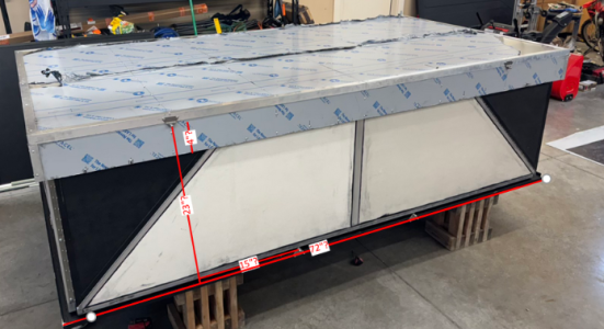

I have a full rear hatch style door on my camper. I wanted the struts to fully open it (weighs ~70 lbs) and also pull it closed when it gets close to that point... and not be 500 lb like the calculator suggested! It takes a bit of geometric figuring, but I achieved what I wanted with 150 lb struts, which made the force on the door and hinges much more manageable.
There are places that sell struts of just about any length and force, but you probably know that.
Lots of assumptions here.
Open strut length is 27.46", based on a base of 15" and a height of 23" @ 33 degrees, about 63% of opening force is up, the rest is out.
Closed strut length is 14.93" with a base of 15" and a height of 4" @ 75 degrees, about 17% of opening force is up, the rest is out.

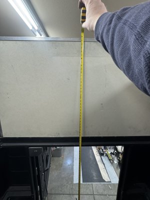

Just put a rope on the ceiling to prevent your guillotine from decapitating you. make it removable so it isn't always up there.

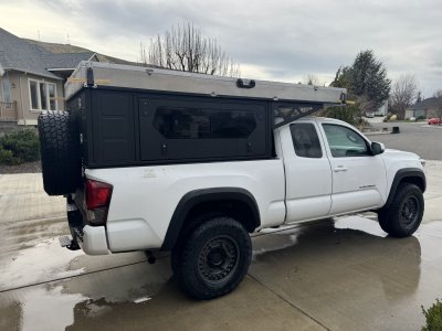

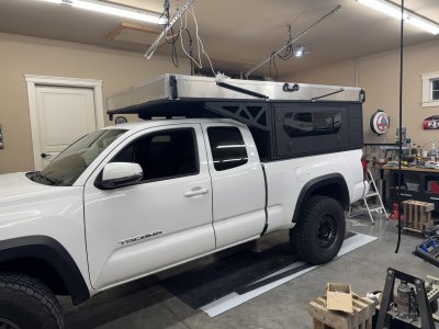

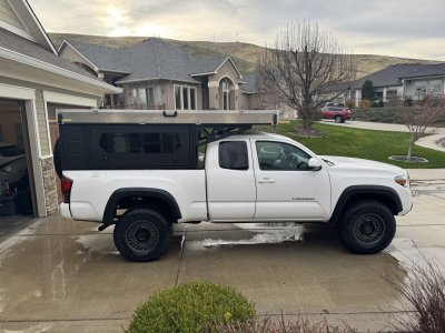

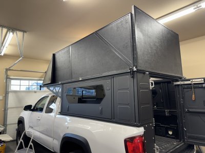

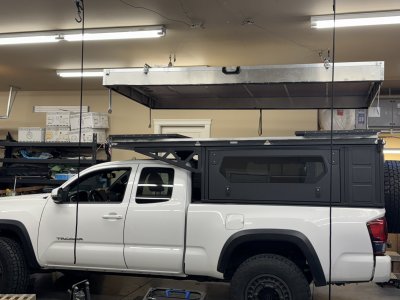

Got a bit more painting done and now it's the first time seeing it all on top of the truck! Right now it's painted in off-the-shelf Rustoleum bed liner (mostly for impact protection), but I will likely top-coat it in white paint in the future to make it easier to keep cool.
This thing is tall when it's popped up! The head room stands at 78" from the pickup bed, almost 6.5 feet tall! I'll likely lose an inch when I insulate the floor, but headroom is not going to be a problem.
Seeing and experiencing the height really reinforces my decision to go with this design in the first place— the headroom (and more) and rigidity of a solid truck bed camper when it's popped up, and the stealthy low-profile airflow of a canvas popup camper when it's folded— best of both worlds.

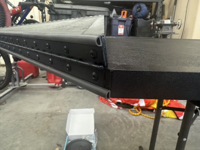

I've also been working out the details on how I'm going to water/dust/bug proof this thing when it's popped up. The walls and roof section are constructed in such a way where gravity does most of the work in keeping water out of the cab (think overlapping shingles), but there is one section which needs special attention— the triangular folding sections near the front and back.
I've seen a few solutions to this area in other designs out there. Some use waterproof plastic hinges, and others use regular metal hinges with a flexible plastic covering over them. Originally I planned on going the plastic hinge route, but abandoned it after experimenting with them and not trusting their long-term durability. Putting a plastic covering over traditional hinges also seemed like solution that would eventually wear out, so I decided to go with a different solution.
As you can see from the above picture, the hinge is not waterproof when the roof is folded down (not to worry because the roof provides all the waterproofing in this stage). But when opened up, the two D-shaped silicone weatherstrip sections squeeze against each other, and hopefully provide a nice watertight seal. At least in theory...

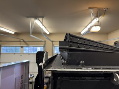

Some other various pictures.
In case you were wondering, in the above picture you can see the "guillotine" I mentioned in my previous post. Any body part caught in this section down the middle as the roof is collapsing is going to get mangled.
As you can see in the last picture, the frame is still pretty rough from some recent modifications, but it's about to receive a final coat of paint before the roof goes on.

P.S. I know I owe everyone some measurements for the struts and attachment points, hope to get that for you soon.

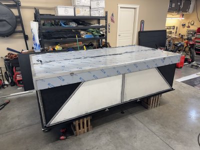

And now the roof is on and attached to the walls! The existing hoist in my garage (for my kayaks) came in pretty handy.

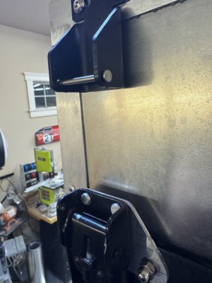

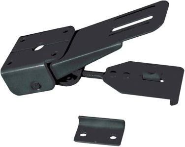

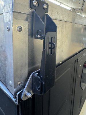

Following is a closer look at the latch system I devised.
This is how it looked stock when it arrived from Amazon.
The main latching mechanism is great, but I didn't like the catch piece for a couple of reasons:
  1. It was very difficult to get it aligned properly without having to put an unsightly spacer behind it.
  2. Because it is open-ended, theoretically it's possible that the latch could slide off sideways in certain situations. Under normal circumstances I think it would be unlikely, but in the event of a collision I could see a situation where the roof could slide forward, which would cause the latch to slip free from the catch, and then the roof would be free to be thrown forward from the vehicle (assuming the latch didn't outright fail first). I think this is a highly unlikely scenario in the first place, but any excuse I can get to design and manufacture a custom part, I'll take it!
Following is the design I came up with, then sent away to SendCutSend to have manufactured in 1/8" stainless and powder coated. Happy to share the cut and bend CAD files with anyone if they want them.
I like this design for a few reasons:
  • It aligns perfectly with the latch now.
  • It's made out of stainless, instead of powder coated steel (although the lower latch mechanism is still steel, but I'll likely upgrade it at some point).
  • It holds the latch captive in the horizontal direction, so any unexpected movement of the roof in that direction would keep it from slipping away.
  • I could drill additional holes for the clevis pin if I needed a larger adjustment range.
  • The split ring on the clevis pin will come in handy for hanging a removable locking pin (or padlock) so I don't lose them.
I'm also happy to report that the gas struts seem to be providing more help for lifting the roof than I originally thought. Not sure why it seems to be easier now, but it's possible that the roof was getting hung up on the walls due to the flexing of the frame in bench testing. Now that it's mounted on a sturdy frame it seems to be much better. I may still decide to move to 50 lb struts (from 40 lb) to give a little extra oomph and to counteract the additional weight I'll gain from solar panels, windows, ceiling covering, lights, etc.
