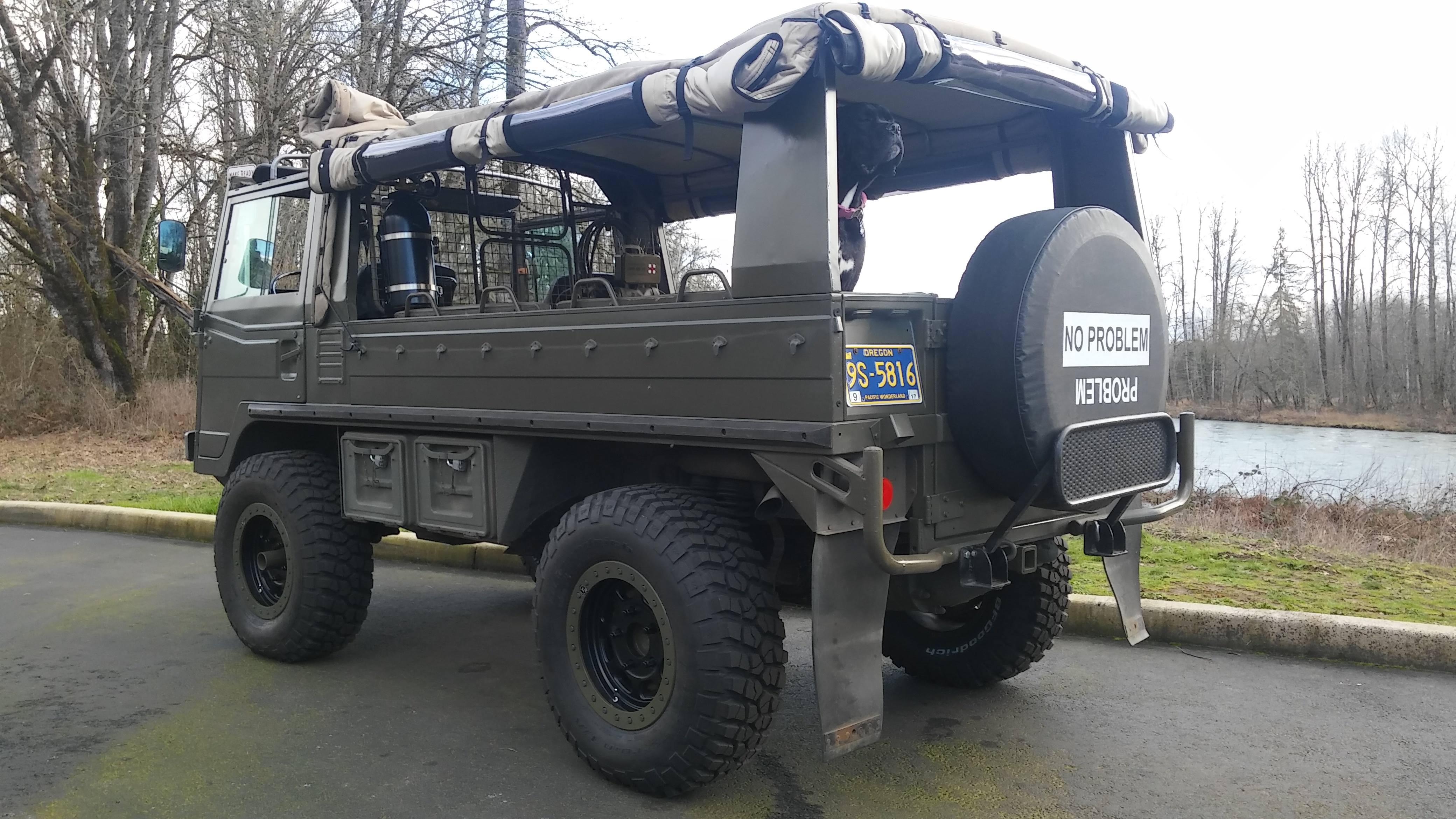

Have you considered the Trail Ready HD17 wheels - they are race proven and do custom patterns all the time and can do up to 6 inch backspacing on a 17 inch x 8.5 inch rim with a outside beadlock ring. They are local to me as well if you needed any assistance making it happen.
http://secure.trbeadlocks.com/17x8-125-45hd17beadlockwheel.aspx
Several people are running these on Pinzgauers with portal axles boxes - so they should fit you setup.
