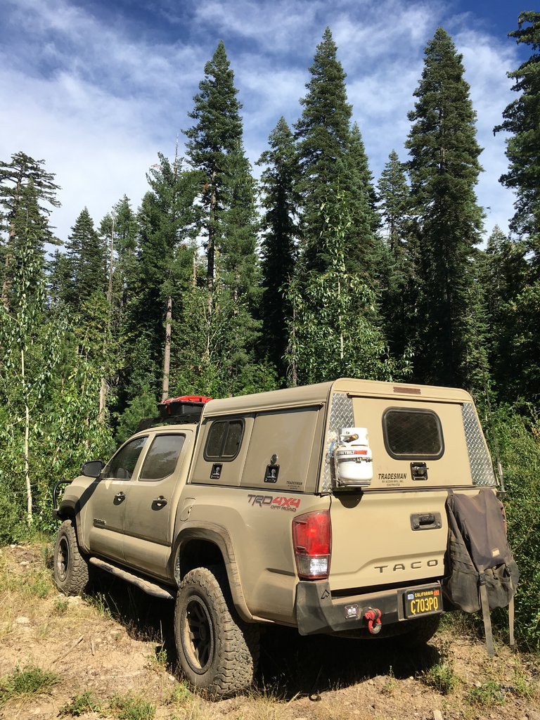

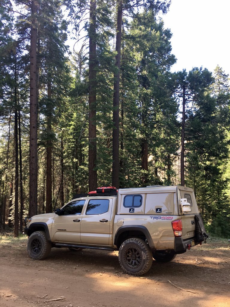

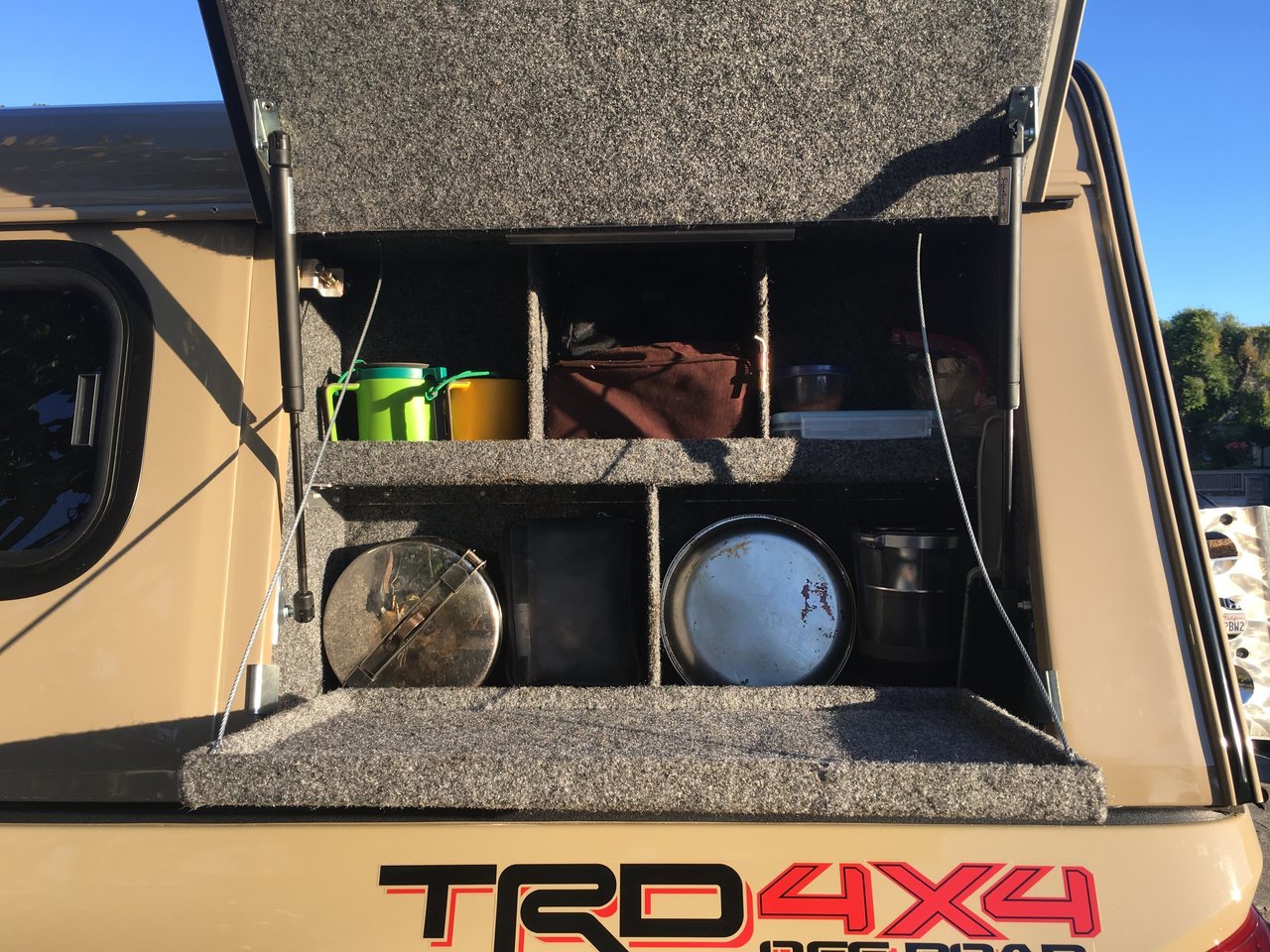

Here's a great example of what can be done with a Tradesman.
https://www.tacomaworld.com/threads/tradesman-truck-tops-commercial-style-topper-shell.504188/
fullsizerender-21-jpg.2237016
img_6038-jpg.2237024
img_6160-jpg.2237039
Yeah, saw that on instagram, looks like an over engineered/design that complicates the process. I'd rather drill two holes in the indoor, install the maxtrax mounting pins and call it a day. Easy to waterproof as well. Or get some of the front rung ring tie downs on the m8 system. And secure them to the ceiling of the canopy.
