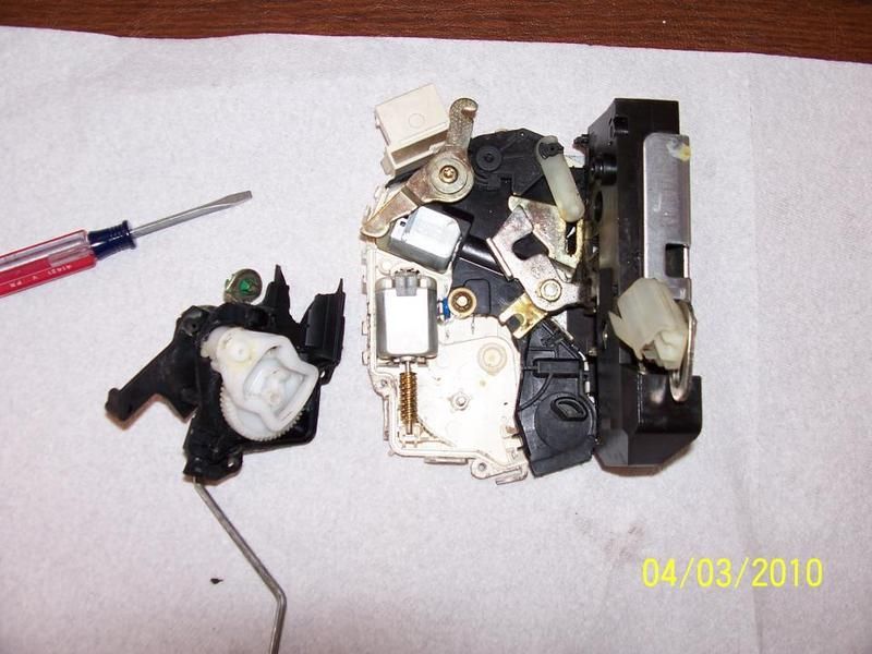

What I did was break off the cover where the super lock is located.
(Not my picture)
Then I pryed the super lock out of its home which will allow you to activate the latch assembly with your pick.
I wish I was there as its so much easier to do than explain. ;)

no that actually helps a ton! at this point breaking the **** out of this thing will be extremely satisfying haha
