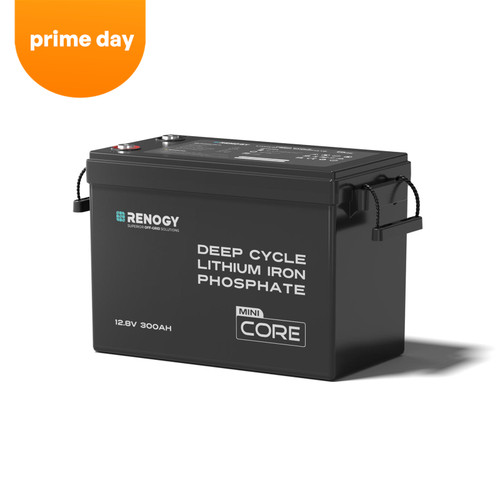

Anyone try the new Renogy 300 ah mini Core ?
They get poor reviews on Amazon... :confused:
All of these products are kind of a crapshoot, and users very rarely test the batteries. If you buy on Amazon, assume that you have a 30 day warranty, and test the battery thoroughly... or just take your chances. The support might be even worse if you buy direct. I bought a Power Queen that I tested thoroughly and it was defective, and the company just tried to waste my time until the 30 days were up. Amazon took care of it though.
If you think you'll use these in below freezing temperatures, "self heating" is a better feature than "low temp cutoff". Self heating means the battery will use incoming power to heat itself, then resume charging... at least that is how the good ones work. Say you are traveling and it's below freezing and the battery isn't in a heated space, the self heating battery will still be able to charge.
I also like the idea of having at least two batteries in case one dies.
If so, what is your opinion of it ?

Personally, I put more stock in no-name Chinese lithium than anything with Renogy stamped on it, which is best known for the trouble it causes. LiTime has good support and a 10-year warranty and lots of happy customers, might be worth a look at instead.

I don't have any experience with the 300ah Renogy battery you mentioned, but have had Renogy products for years, panels, batteries, chargers, never had a single issue with any of them.
Amazon reviews are not always very accurate, people give 1 star when a product shows up late, or they don't know what they are buying in the first place and their issues are largely operator error. As mentioned above, Will Power's YouTube channel is a great resource for battery reviews, he has a thorough testing procedure and cuts the batteries open to see how they are made. Lots of options out there, no question.
