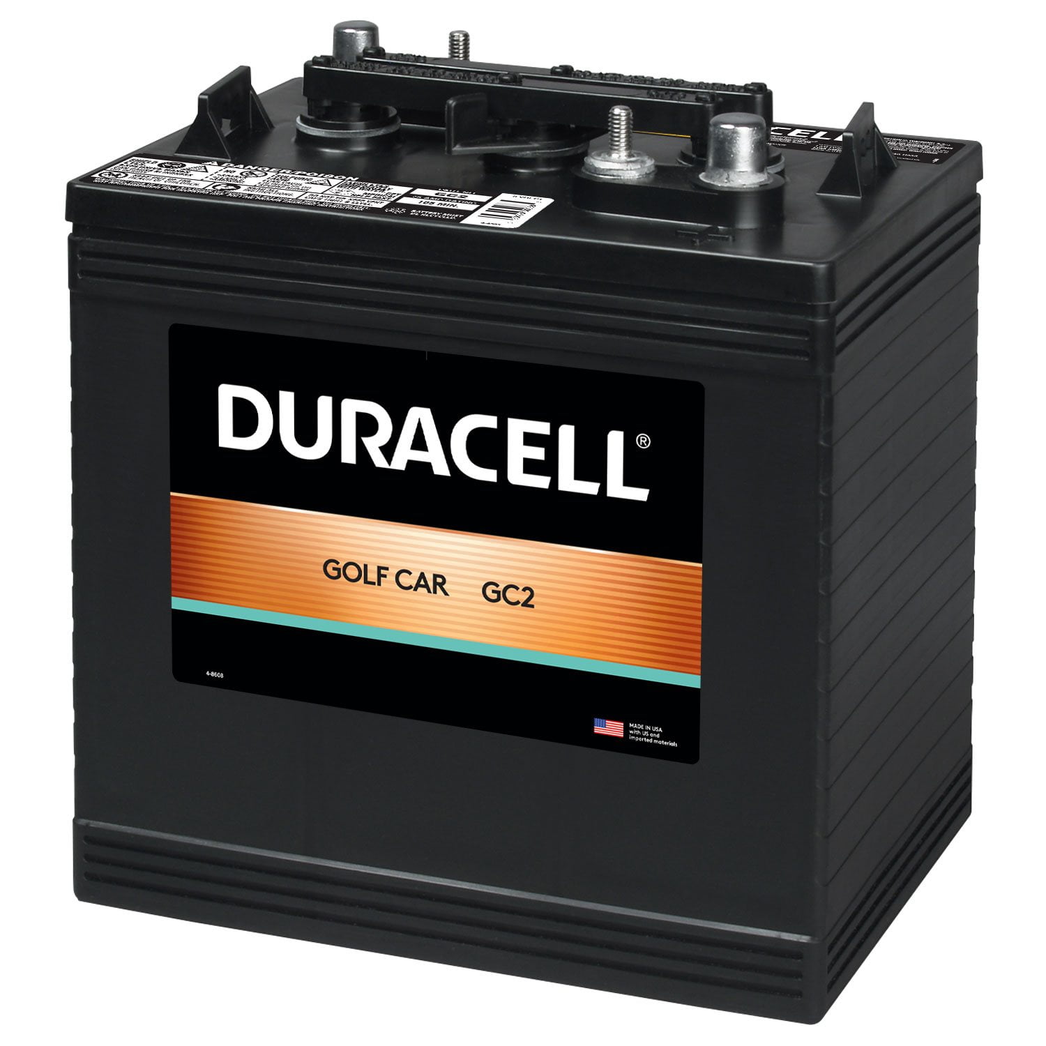

GC's? golf cart batteries? Then I have to add solar controller and a charger. And the performance for the weight/size is not anywhere near as good as lithium chemistry - I'm really trying to solve for size, weight, and portability. I'd consider a "permanent" installation of two smaller 6v AGM batteries, but to get the same performance (roughtly 500 wh) It would be 2x the size and weight of the lithium based solutions, it seems....

AGM at 100Ah would be a lot more expensive than the Duracell GCs, and not as durable either.

I'm trying to parse this, but I don't understand. Can you explain a bit more? By "GC" are you referring to something like this:

Yes those Duracell GCs are the best battery value on the planet.
But will only accept average say 30A input at best, much lower after 80% SoC, any lead will take **many** hours a day to get back to full.
