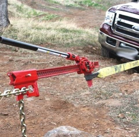

"it is a hazardous design". No, it is not. It is a machine, a very simple machine. Combined with even a rudimentary understanding of physics it is capable of extraordinary things, limited only by the imagination.
I can winch with mine, I can clamp, I lift my bumpers, my sliders, my tires, I can brace, I can cut metal like a car door or a roof, or an A pillar.
In this article are some great Hi-Lift jack accessories that should be a part of your Hi-Lift recovery Kit. I own several of these as I am a big believer in maximizing utility. BTW, none of these things fits the ARB Jack......

I like the JakJaw accessory above. I haven't seen that before. I have the Hi-Lift Off-Road Kit, Lift-Mate, Bumper-Lift, Off-Road Base. 3"X 15' Tree Strap, Fix-It-Kit and a small can of BP Blaster. I just added a JackMate. It comes with a replacement push pin for the Hi-Lift base. If I chose not to use the base, I can dismount the jack by removing one bolt and the base pin. Base is held by two other bolts. I was not satisfied with Loc-Rac Bedrail mount that Hi-Lift offers.
