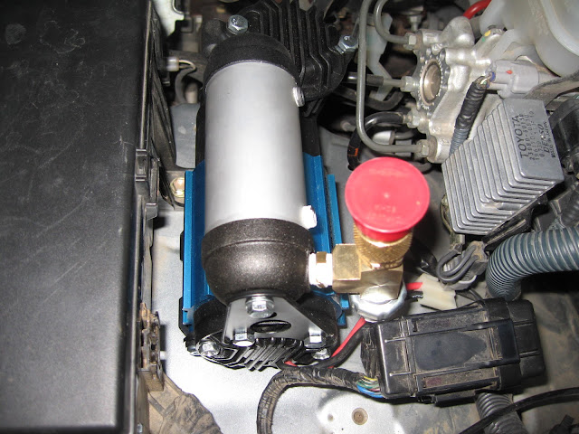

I have had the CKMA12 under the hood of my truck for six to seven years without a problem.
Yesterday as I fired the compressor up to air a tire the compressor suddenly stopped running. Yikes. I traced out the power and control leads and found everything was fine up to the point of the last plastic connector at the compressor motor's power wires. Apparently as the metal contacts went bad (corrosion?) they overheated and melted the connector's plastic body which broke the electrical connection. A subsequent measurement of the compressor's current was 17.5 Amps no load and 23 Amps under load. Any resistance at the metal contacts could translate into heat so no wonder the connector got hot enough to melt. Definitely an argument against overly extended running of the compressor. I cut the old connectors out and installed Anderson Power Poles with 45 Amp contacts and weather boots to help keep water at bay. Runs great again!
It might be a good idea for folks to periodically unplug the connectors on their compressors and ensure the metal contacts are clean and mechanically fitting together properly. Or replace the connector as I did.
