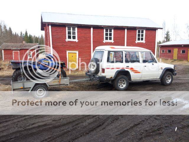

yes but did you notice the flywheel cover??? what engine??

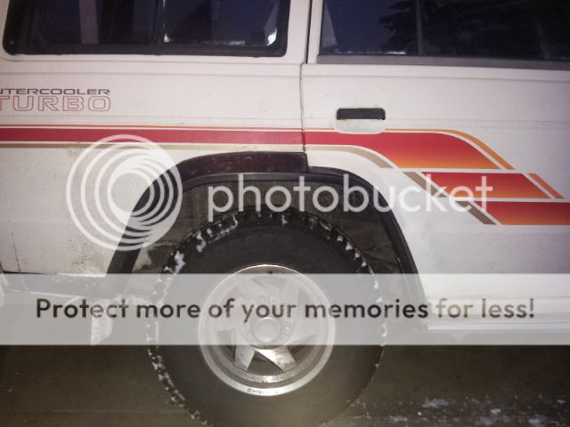

and also in this pic you can see how low the right side torsion bar has gone if the rain stops today iam goigto move it 2-4teeth and try to get it back to same level as the left side.
Uh..Polaris?
