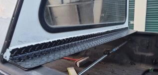

With used ones you are going to have to go by the measurements, and you will probably find one that is close. You are also going to have too either call the dealer or swing by as well. II have found that they usually don't advertise them.
If you look close at my pic above you can see a 4 inch gap between the cab and the topper. I just filled the gap with a folded piece of diamond plate.
I have never had an issue with the gap. I actually prefer it now, gives me a place to put drinks etc while I open the doors, lol.
And as above, I agree, if you are going to have a roof rack the sloped topper is not super critical.
Shawn
