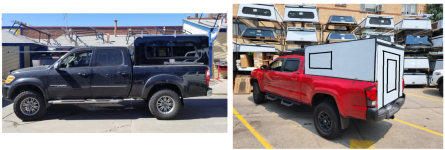

I've been thinking about a custom truck camper build for a while. While I don't have the skills to build something completely custom, I'm handy enough to make modifications to an existing platform.
I found that I can order an ARE DCU commercial cap in a rectangular shape instead of the standard tapered-in design. They call it the "radius front straight" option and charge about $200 extra. It only comes in 29" height or 36"+, which works perfectly for me since I want 29" height on my 3rd gen Tundra 6.5 ft bed. The attached photo gives a rough idea of what I'm envisioning.
The plan is to order a plain shell with a full single door for rear access (deleting the tailgate), no side doors or side windows. I don’t like their standard window options, so I’d rather install RV windows myself. I may add a ventilation fan later, but it might not be necessary if I can achieve good airflow from windows on both sides.
I think this is a great platform to build a fully customized camper on a low budget (around $3–4k for the plain shell), but oddly there isn’t much information available online. I searched “ARE DCU radius front shells” and only found a couple of photos. I always like hearing other people’s opinions, so I wanted to share my idea and see if you see any flaws in my plan.

I have an ARE topper used for work on a Ford ranger with a lot of off-road Miles's well. 200,000 miles / 8 years and everything is still holding up very well.
1) Should I get the regular DCU or the DCU MAX? I believe the only difference is the aluminum skin thickness (0.035 vs. 0.063) and heavier duty hardware. I’m a bit worried about dents, but either thickness would dent under moderate force anyway, so I’m not sure the MAX is worth the extra $1,000.
If you are talking about the 2022+ Tundra, then the thicker one will be fine. Earlier models flexed torsionally quite a bit, and a stiff aluminum shell would wear out and break eventually. $1000 doesn't seem that bad for ~2x the durability. It will be heavier too of course.
Offroading shouldn't be a problem.
Regarding the height, I'd get one that allows you to comfortably sit up straight on your bed/chair/couch or whatever. Less than that is a pain. For me that is about 54 inches from the floor. The bed is 20.9" deep, so the 29" model wouldn't be high enough, but if you are short, it could work.
