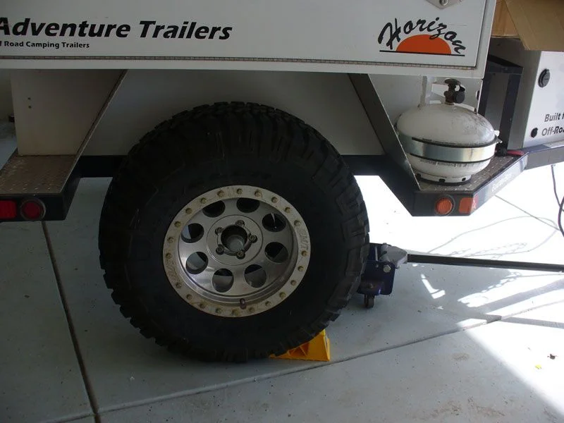

I recently bought an AT Horizon, but it had Jeep Hubs and 33" Tires. I wanted to be able to use my 35" Tires on Toyota Rims.
I went to a local trailer shop and bought a 10" Dexter Toyota Hub with the bearings and seals.

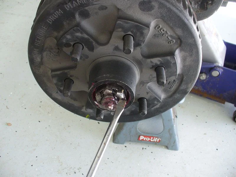

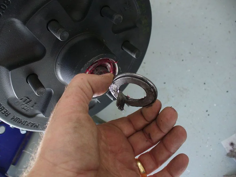

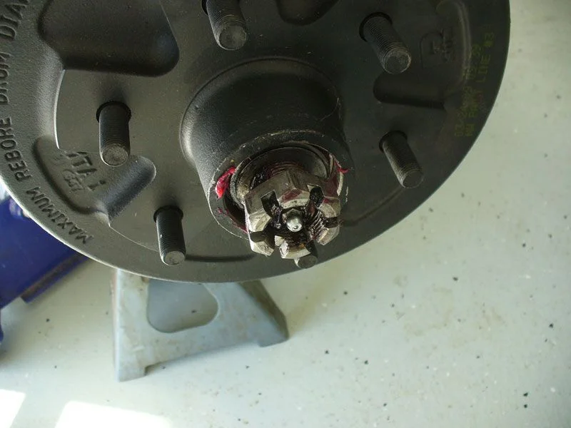

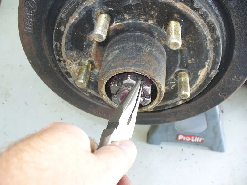

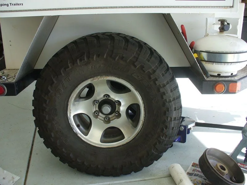

The first thing of course is to remove the tire and the axle dust cap
Next, bend back the tang on the lock washer and then loosen the retaining nut
attachment.php
attachment.php
attachment.php

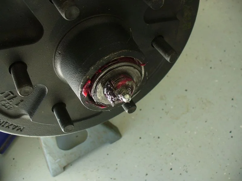

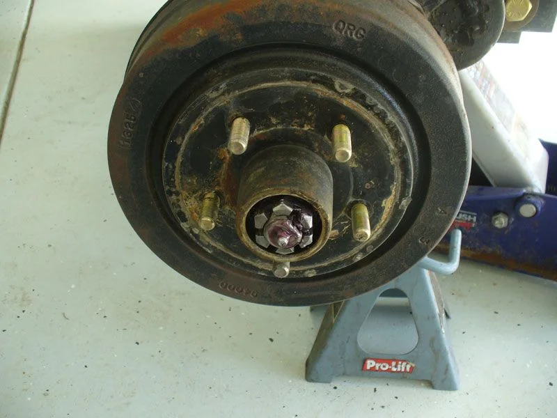

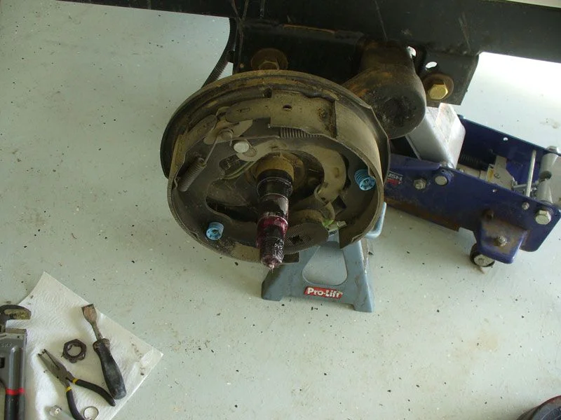

With the nut removed, remove the old Hub

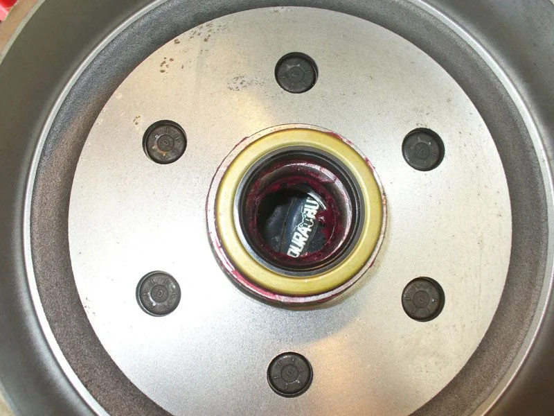

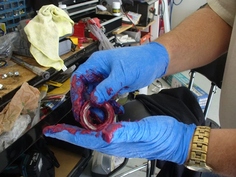

Pack the new bearings.
I use Mobil 1 Bearing Grease and roll the bearings in my hand till it is well into the inners of the bearing. You want to see grease come up through the inner ring
Tap in the inner axle seal and ensure it is fluch with the inner part of the Hub.
I also put some grease on the inside part of the hub that goes on the spindle

Put the new hub on
Install the outer bearing that is also packed with grease
Install the lock washer
Add the lock nut

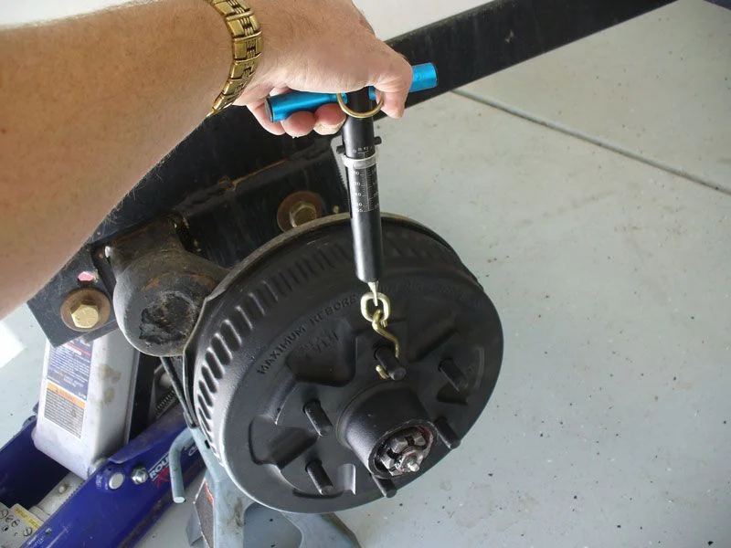

Now you need to tighten the lock nut until you can't turn the drum. This will set the bearings and seals in place.
Then loosen so the drum turns freely, but not to loose.
For those cruiser guys who do their own front axles, I used the fish scale method and set the pre-load to about 10lbs. Never done this before on a trailer, but it seemed about right to me
Then push the tab from the lock washer into place
Install the tire an torque the new nuts.
You can replace the Dexter bolts with Toyota's so you can use the same lug nuts if you want

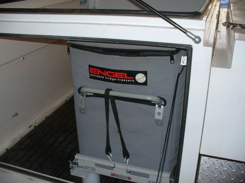

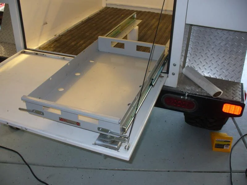

I also installed the ARB Fridge Slide.
Lesson Learned: I installed it to far to the right so I had to modify the right latching mechanism

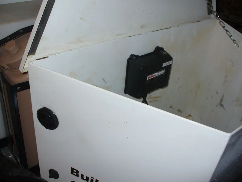

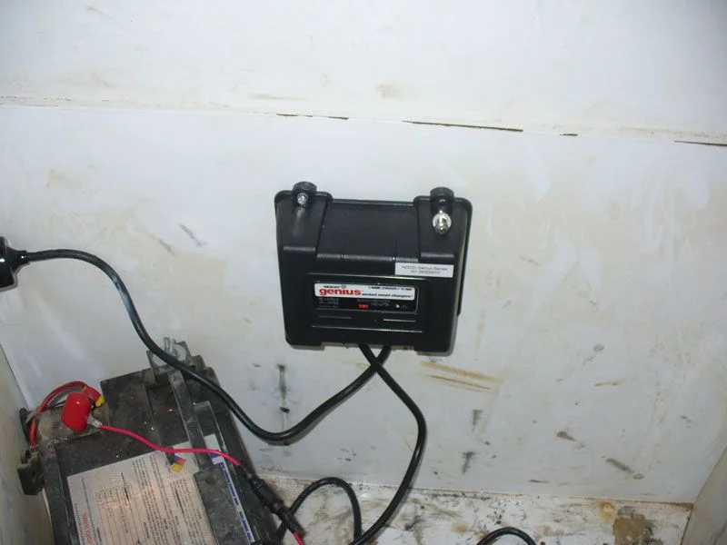

I then installed the Battery Charger and shore plug so I could charge it off of 110V rather than just the truck
attachment.php
attachment.php

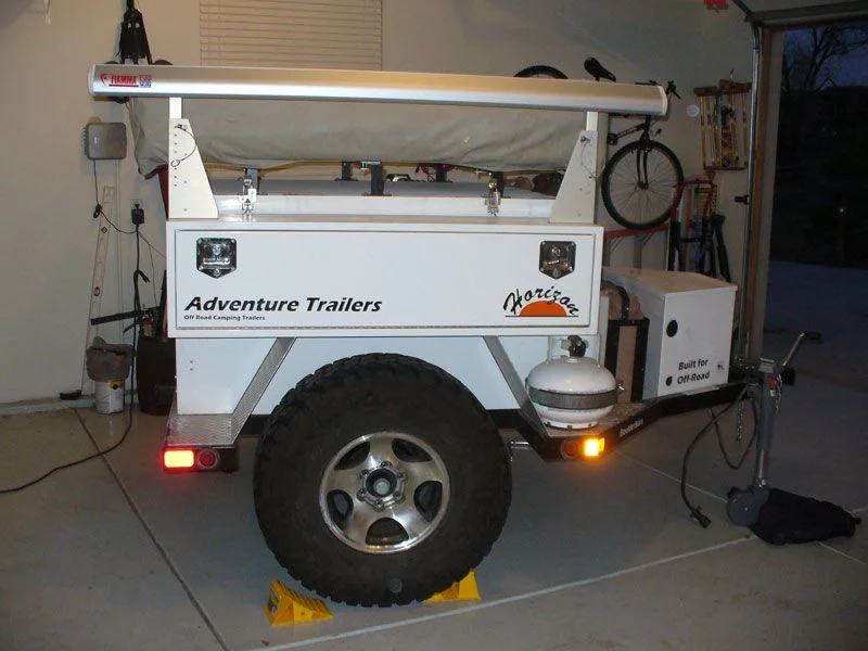

Now I just need to swap the RTT for the one I want and I am set.
May want to get larger or at least a spare Propane tank and come up with some kind of heater system

Cool deal. It's fun to wrench on trailers. That hub swap was a piece of cake. Ours came with Jeep bolt pattern 5 on 4.5 so i used wheel wheel adapters for our 80 series wheels.. it bumped the tires out about 1", which made for a better stance and increase in stability.
Careful on the rubber straps on the fridge.. they'll snap or stretch and your fridge will move around. I've tried it. If you do use those, make sure they're hella tight and check them often.
I know what you mean. The straps are short term. You will notice I have the clips on the front of the fridge for more robust hardware like these
I had just moved the fridge from the back of the truck to the camper, but not yet the mounting hardware. Likely to go wheeling before a camping trip. so the fridge will be in the truck.
Maybe I need a 2nd one :D
tdesanto
x2 on getting the fridge tie downs in place. With that torsion axle, those straps won't stand a chance on even washboard roads. The turnbuckles should secure it very well.

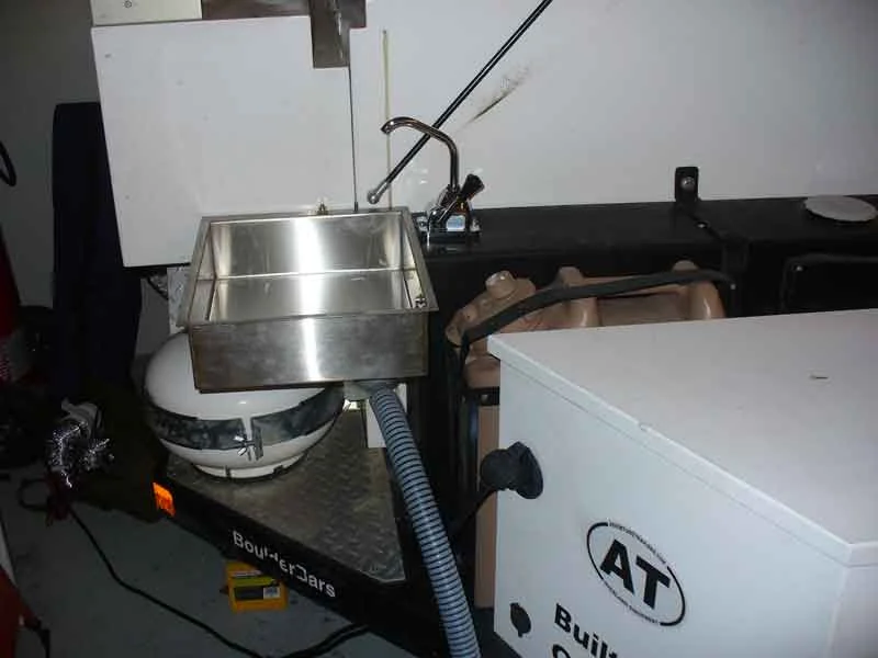

I swapped out the white tank for the Black one and handpump and installed the Sink setup
Of course you take the sink off when driving :smiley_drive:
Installed real easy. Wondering what people put on the hand pump from the tank when driving
attachment.php
attachment.php

Can you post a picture of how the sink is mounted,In other words how is it attached to the main box. Is that the only attachment point? Planning to do the same with mine someday.
