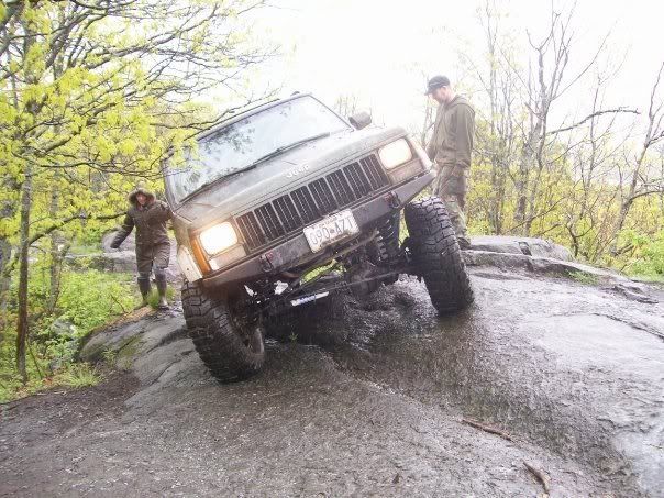

i have run the BDS 6 1/2 long arm on my 95 xj,, excellent kit, tons of flex, the first few times off road it scared the pants off me, i thought i was gonna flip, the kit took me everywhere i wanted to go , my only suggestion would be to make sure you get the upgraded track bar, and drop bracket that comes with it, it might be standard on the kit now, i had issues with the first trac bar , the bushing wore out after 2 yrs , shortly after i replaced the bushing my trac bar snapped , luckily i was on the street and there was no traffic, , BDS replaced the trac bar under warranty but i paid the differance to upgrade, with the 6.5 you will need a sye and drive shaft, and you e brake cables will be too short , 2 passenger side cables from a 92 or up ( tj i think ) were a perfect fit.

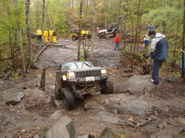

Is that second picture from B&D in brockville? Looks like the hill top on that trail.
