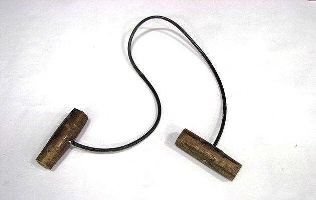

When I got my Vehicle Extrication Instructor's Certification, one of the things we were teaching to remove a windshield intact was to use a thin flat blade and poke it through the sealant, and then thread a piece of piano wire through the space created. Next, attach a piece of wooden dowel to each end to create a tool that looks similar to this...
latest
With one person inside and one outside, you see-saw it back and forth all the way around the perimeter of the windshield and it will pop loose. It looks like they have a much more sophisticated version of that tool.
