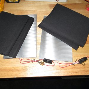

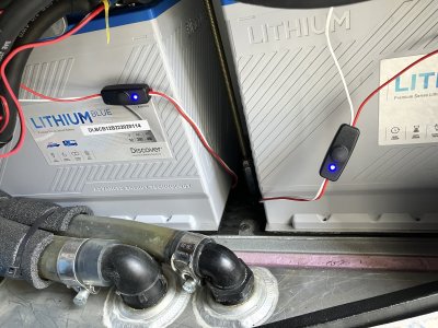

Looking to update this thread with new developments. 1) Although covered in another thread, last winter we installed heated battery trays under our two coach batteries. They draw 1A directly from each battery and are thermostatically activated so not on all the time. This allowed us to discontinue using a space heater while in storage; warming the entire cabin just to keep the batteries online.
On this last picture you can see battery 0114, our problem child :-( Since delivery its been acting up, I detailed some of the issues in post #16. Last week the BMS shut it down for Over Voltage protection...again. The app revealed one cell was 400mV higher than the others - it wasn't coming back to life. Sent the details off to Discover Battery tech support and received a reply within hours that it needed to be replaced and would be covered under warranty. Today, three days later, I've swapped in the new battery and all looks good (fingers & toes crossed).
Huge credit to the company and our local dealer for not p*ssing around like so many do. OTOH, we just purchased new kitchen appliances and, after reading the dismal industry-wide reviews on appliance warranties, I'm dreading the day we might have to file a claim.
