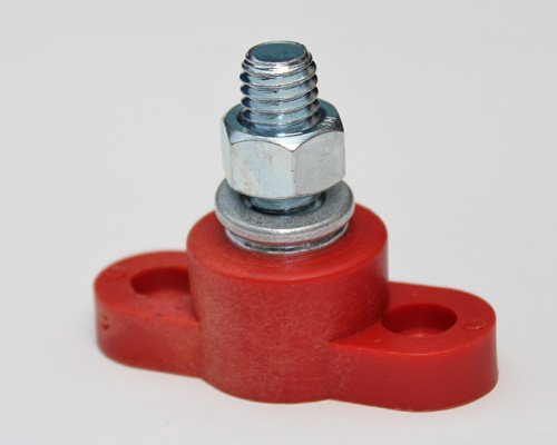

Last question. How do you deal with cable management when you have several (2-3) cables going to the + terminal? I'm asking because I'd like to install quick disconnects (see attached) on both batteries in order to quickly disconnect and remove them. How could I have 2-3 cables connect to one of these Quick Disconnect connectors? If I eliminate the ground bus bar perhaps I could have a bus bar for each battery? Is that overly complicated? The current install I have (done by PO) is a mess and has several cables connecting to the battery. I'd like to have one if that is realistic. Thanks again for your patience with all my questions.

Instead of bus bars, you could just use a power post and stack all the wires on a single post:
http://www.amazon.com/Positive-Insulated-Battery-Power-Junction/dp/B00784HYI2
