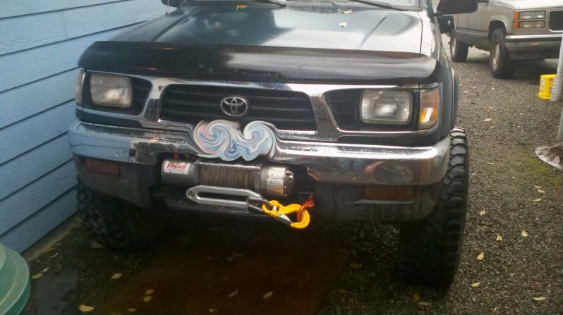

I got the bumper winch remote plug finished up, the solenoid box hidden from view and the winch is now all wired up and working!
Overall without the winch plate or winch on (was redoing the fairlead mount):
Close up:
I repositioned the fairlead mounts back further onto the winch plate to put it far enough back so that the plate will hit the rocks/trees/whatever before the fairlead does, I didnt like how it was hanging out past it. Hopefully keeping it from getting messed up and ruining my new fandangled winch rope, which came in last night.
Here is the hook...I'm hoping it's going to be strong enough.

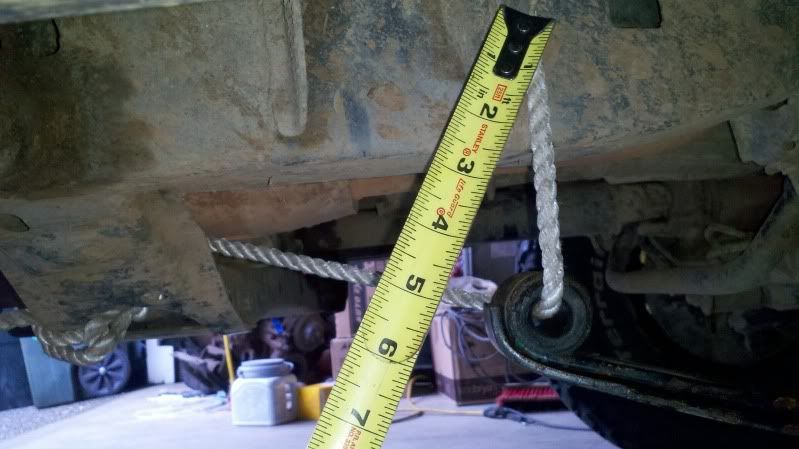

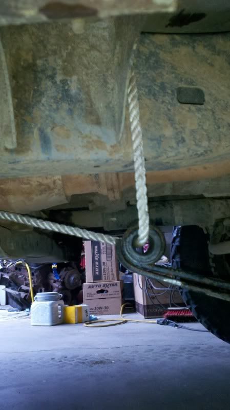

Here are some measurements for those that want proof of how poorly this will turn out. :p For reference, the truck is in a flat garage and has a 3" lift with 32" tires with 18 1/2" frame height for reference. I plan to use the TG rear shackle mount kit, I like the design better than sky's, I was planning to make my own rear mount but since it measures out to where it will work, i'm going to use it.
Front spring mount: The pin is a little small for the hole i have, but it's about 20 1/2" to the floor.
This is where the spring lays slack at, the mark on the frame is 48" back from the front mount, but i flattened out a spring and it's actually 47" eye to eye. So that will provide a better angle in my opinion. Imagine 1" forward of the mark on the frame as being where the spring will lay under load.
The TG shackles are 5" long, you can use your imagination as to where the shackles will lay.
