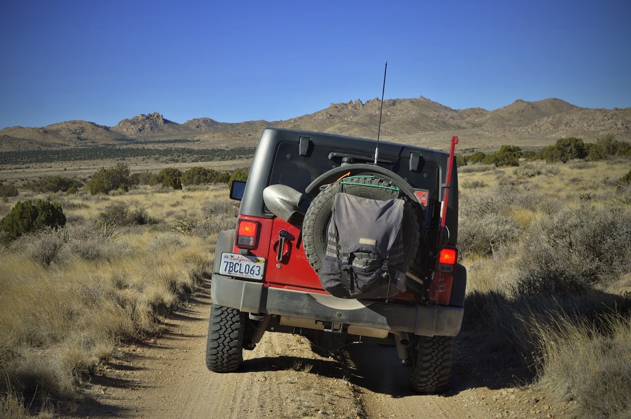

I have to say, Your jeep looks squat way more than mine does when loaded. I wonder did they tag your springs wrong? Have a look at the maximus 3 tire carrier as well. They have a nice setup for carrying everything.
Wow. Mine is NEVER like that. Hmmmmm. I am thinking your springs are not what they are tagged. that can happen.
Maybe. The front springs are soft. 17s.

Is he running the AEV tire carrier with the stock bumper? That's sort of the way I'm leaning right now too. Looks very functional without the huge $ of the full setup.
Yup. That's what I was considering too. There are a lot of hidden costs with the AEV though. No one offers free shipping. You can't get them on sale. The hi lift mount is $200. You need a way to relocate the third brake light. The gas carrier is another $350+shipping. And the shovel holder doesn't work well with the stock sized tire. Also it blocks almost all of your rear view. The tire sticks out, up and off center.
Definitely a slick set up. But I keep discovering new reasons to just go with the Teraflex carrier.

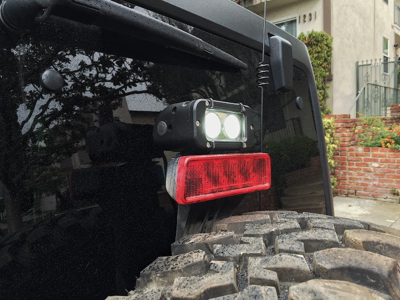

The reverse light is tied to the in cab always-on Blue Sea Fusebox under the passenger seat. I could have had it come on automatically when I shift into reverse. But that seemed like a lot of extra work for something I'd rarely need since I live in a bright city, where a marine layer rolls in every night and reflects the street lights back at you. I also wanted it switchable so I could use it as a camp light and as a dust light. I didn't use a relay on this since it's a 20w LED light >2A. And the switches are rated at 20A. Same for the 3.3A rock lights.

I used water proof splices and heat-shrink wrap and plastic loom to protect all the wiring. The Reverse light wiring follows the 2m Ham antenna cable along the passenger doorsill. I grounded the light to the tailgate handle bolt.
The bracket bolts to the OEM screws holding the 3rd brake light together. I need to sand and paint the 1/8" angle aluminum bracket. But it started raining.

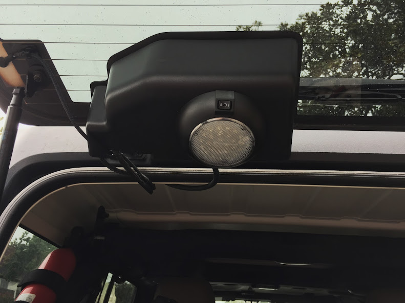

While I was at it I installed a white/Red camp light to the windshield wiper motor cover (Only an $8 part to replace). The wiring runs from the always on fusebox, inside the reverse light switch wiring to the drivers-side doorsill. Then, runs to the hardtop's plugs. I added a plug for the positive wire. The wiring runs through the OEM hard top wiring to the wiper motor. I grounded it to the motor ground. The fitment isn't perfect. I might add a gasket around the light to clean up the install.
