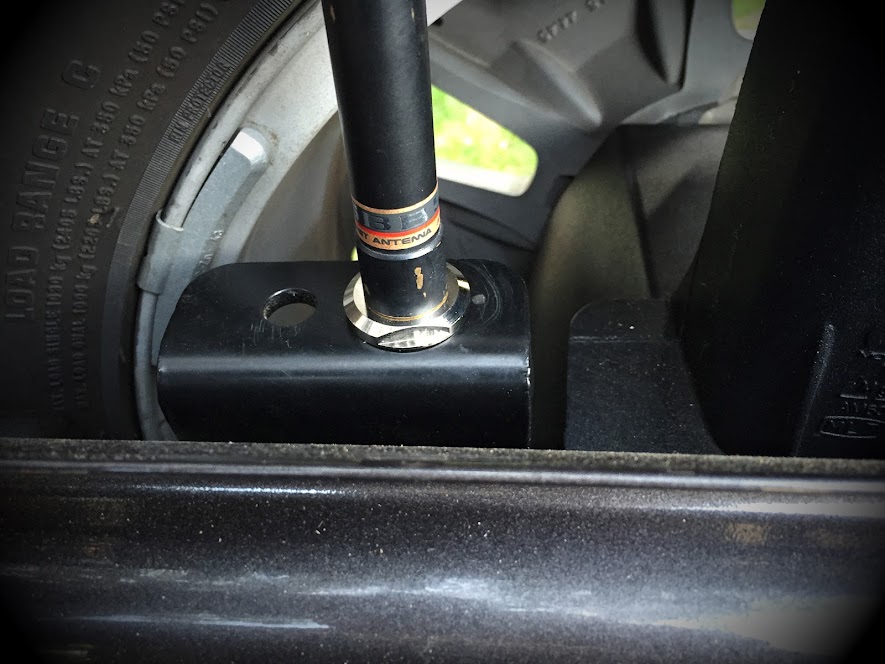

I used the Teraflex antenna mount to attach my 2m Ham radio antenna. The bracket is designed for thinner CB antennas. So I had to drill out the top hole to fit the ham antenna mount. To get a better ground, I removed the powdercoating from the outside of the bottom holes where the bolts contact the surface. The antenna cable routes through the rubber passenger side tailgate grommet, through the tailgate, behind the cargo area plastic and under the carpet to the head unit under the passenger seat.

what model antenna did you install? how long is it?
I installed a diamond antenna, and it supposedly doesn't need additional grounding, and seems to work fine.
