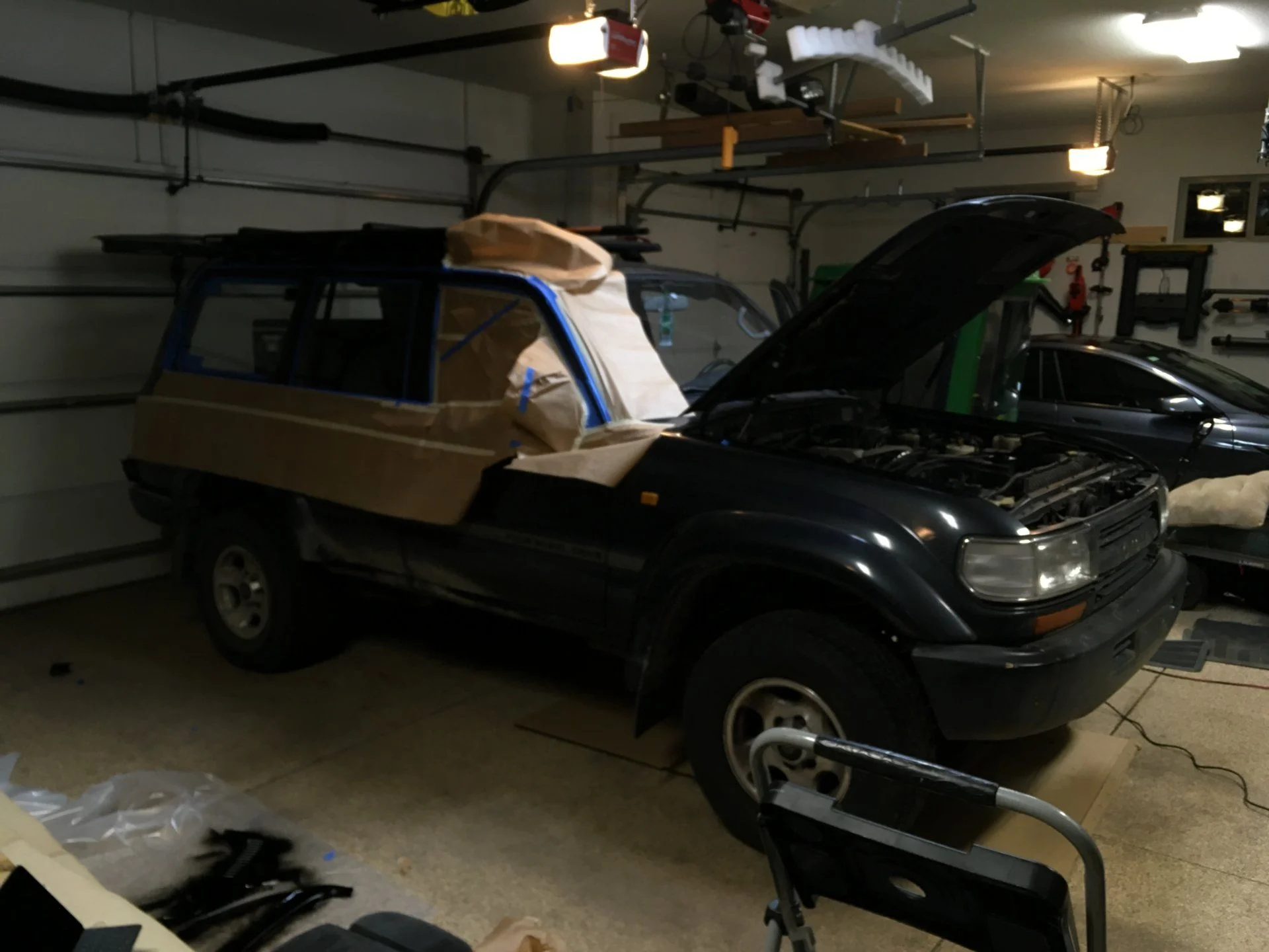

- Repaint the window trim. It was very faded and that black window outline is one of my favorite features of the 80 series.

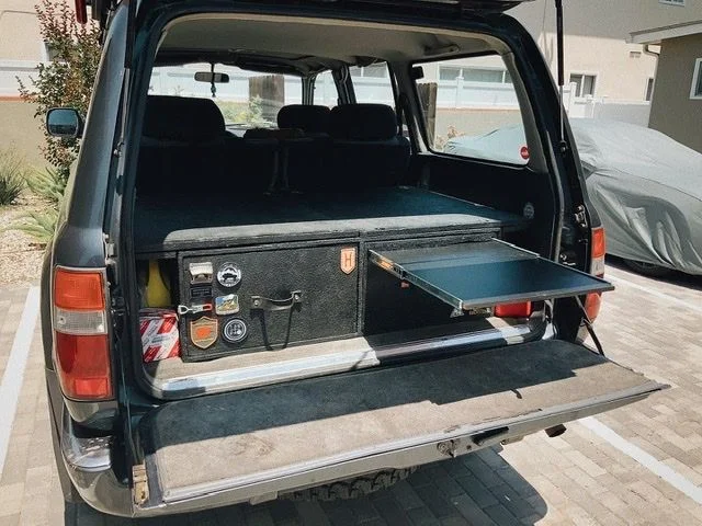

- Install my DIY rear drawer system from my old cruiser.

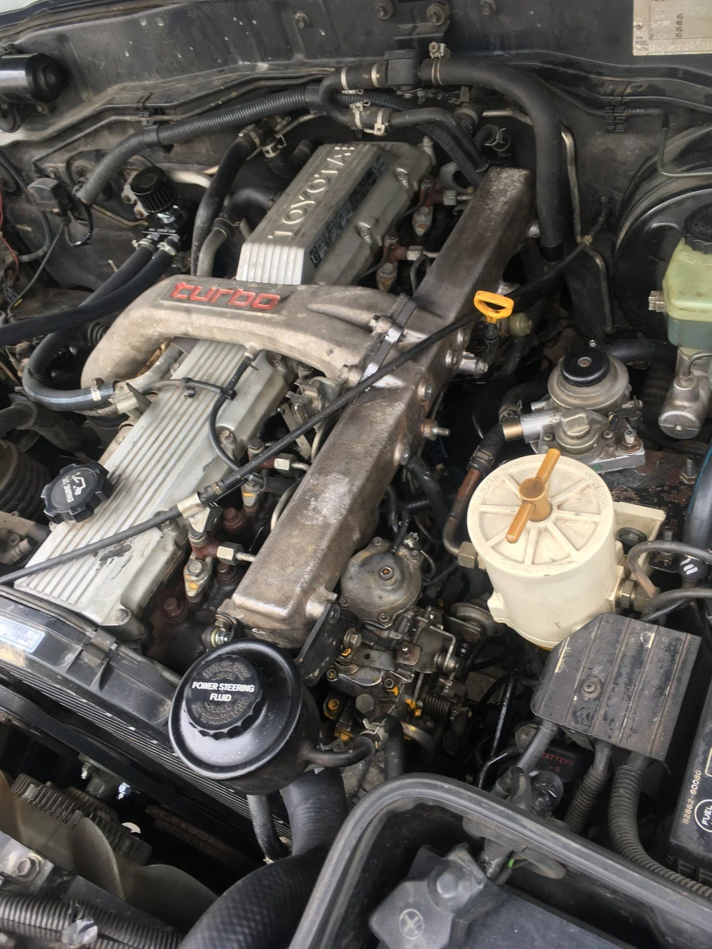

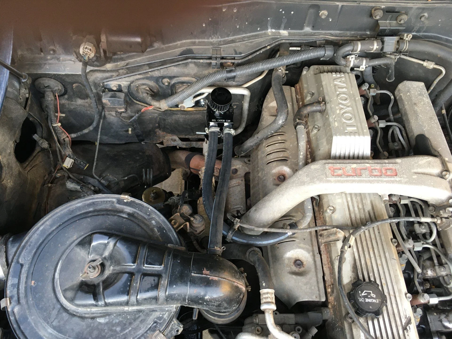

I also installed a small oil catch can:

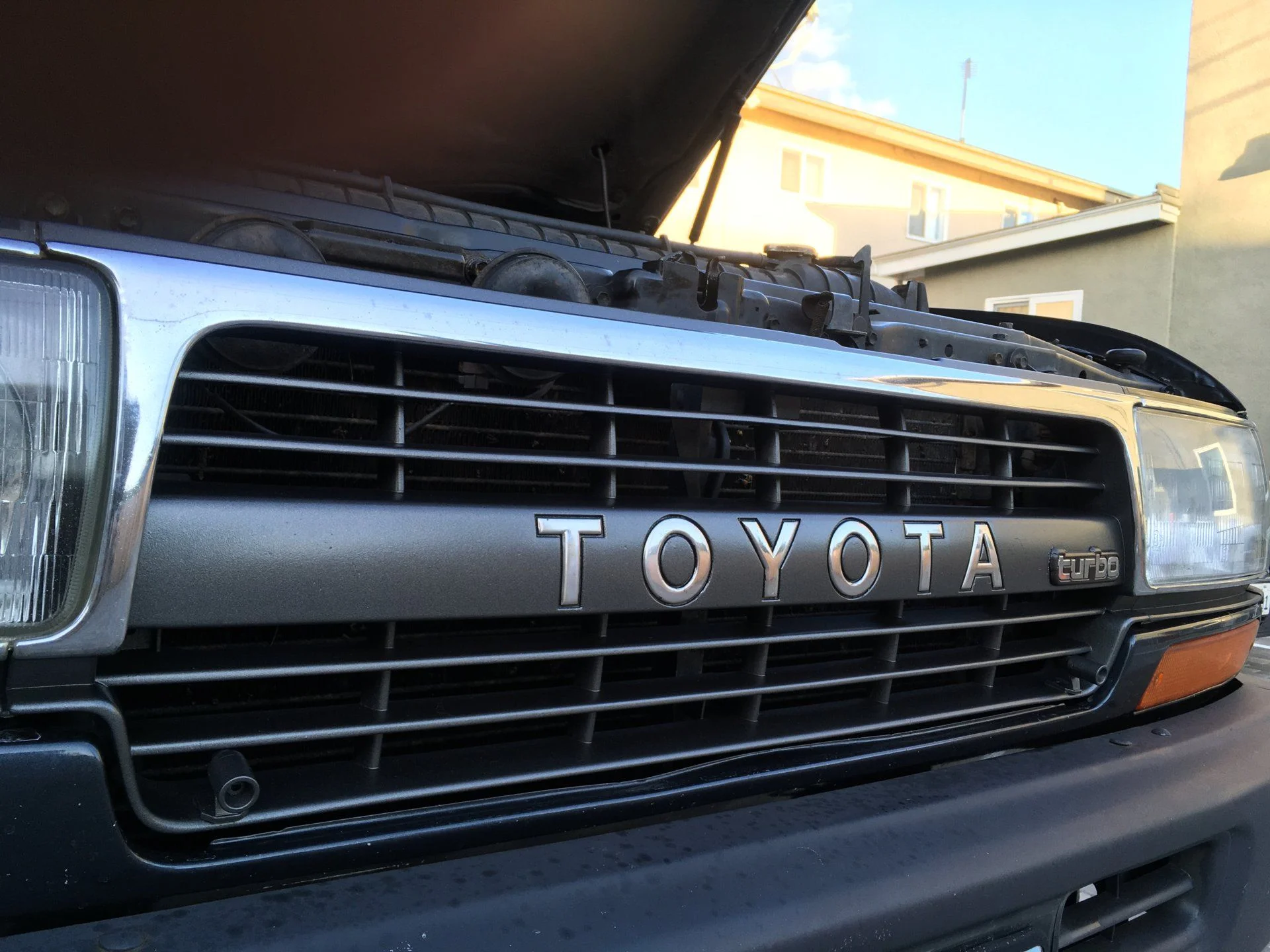

I repainted the grill to freshen it up:
Sloppy shot of the engine compartment:

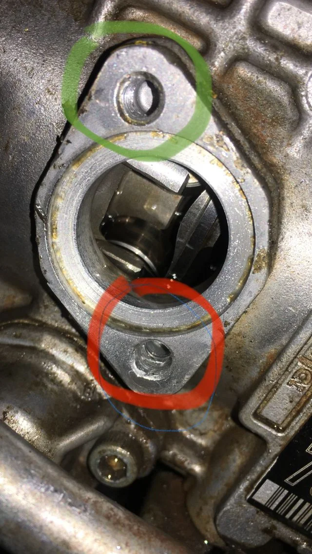

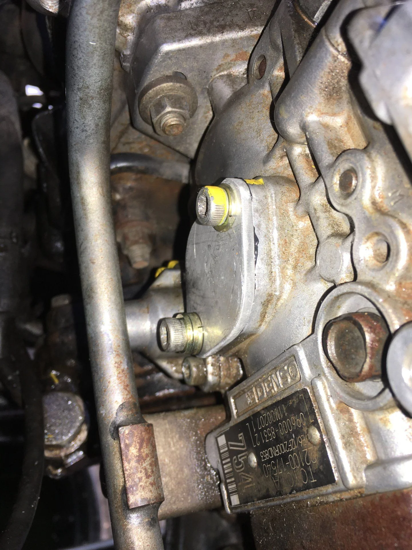

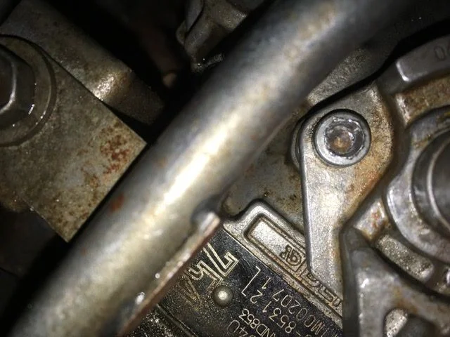

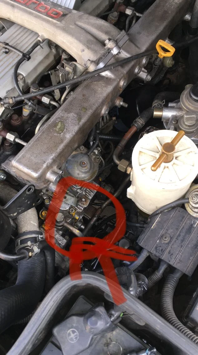

I finally got around to deleting the ACSD... what a headache. I heard it was a super simple job but... not for me. It was damn near impossible to get access in the LHD model. The steering pump blocks everything, PLUS I have an additional fuel filter that takes up even more space.
The 5mm Allen bolts round off soooooo easily... I spent two days trying to get the bolt underneath the ACSD with no avail... I eventually just cut my losses and pried it off. Luckily there were enough threads saved, I could use a longer bolt.
I had the plate my up in Aluminum by a buddy of mine. I used the original O-ring, because it seemed fairly new and fresh.
The rounded bolt... -_-
Green = Good / Red = Ripped threads
Access was tight...
Got it on, adjusted the idle and everything works great! WHJAT A HEADACHE!
Feels good to check this one off of the list.

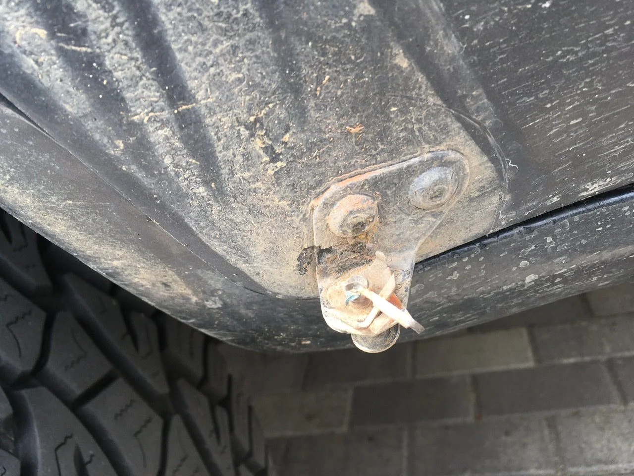

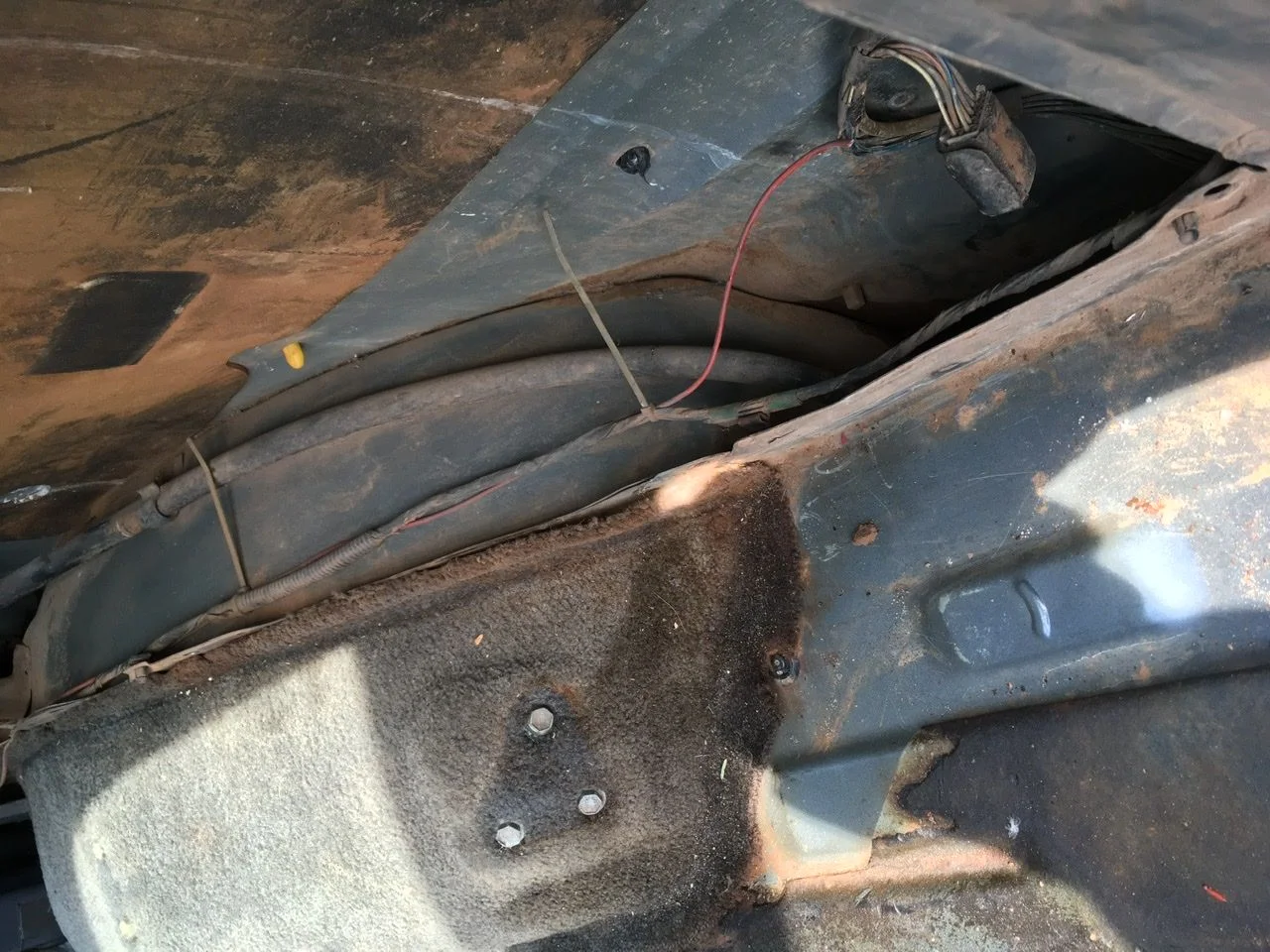

Got around to replacing the old fender flare seals. Passengers side had its fair share of damage and repair... Did the best i could. I think i would love to pull them off and got the truck a more ‘poverty pack’ look in the future.
The Old:

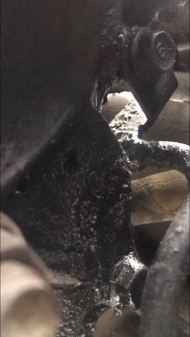

Found standing water and clogged drain plugs in the rear quarters:
The New:
All cleaned up and dry... Already feeling the need for a new project. Quarantine is gonna be the death of me.
