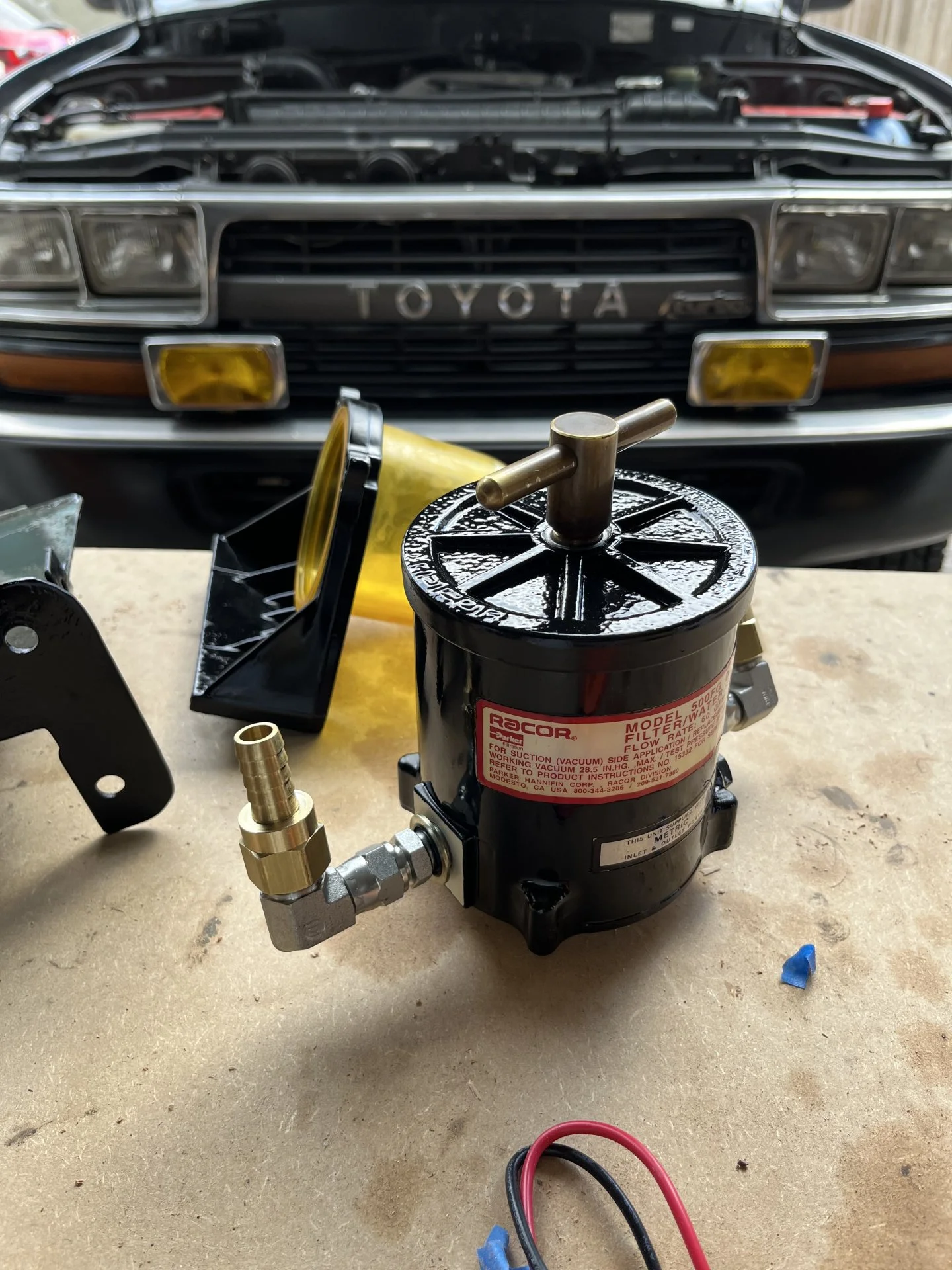

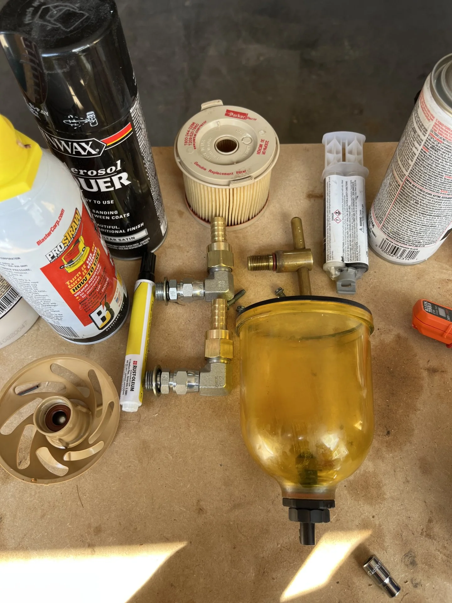

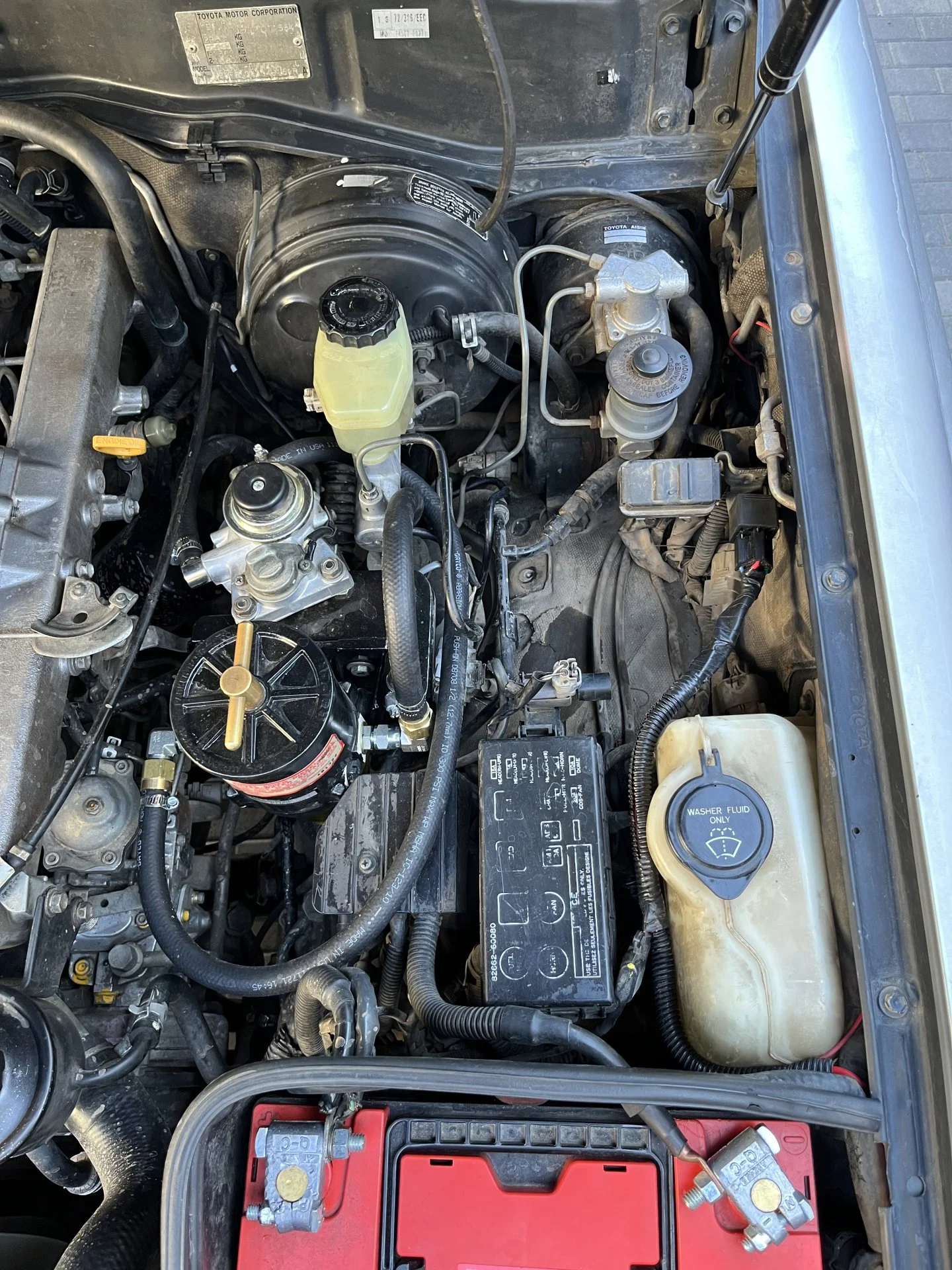

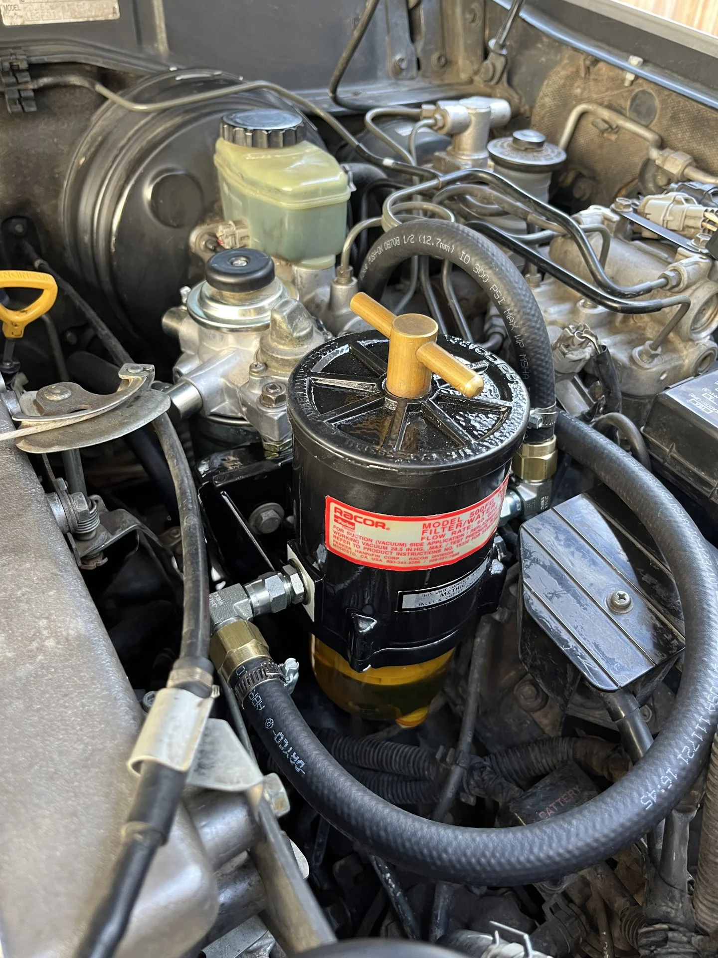

Finally! I went to a custom hose fitting shop (hose man inc) and they helped me get the correct fittings for the secondary fuel filter / water separator. I ran from tank, to Racor, to OEM filter. Works great! No more air getting in! I also painted the housing with black chassis paint so it looked just a little more OEM and refreshed.

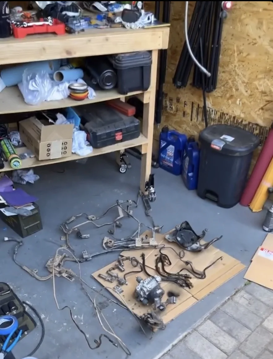

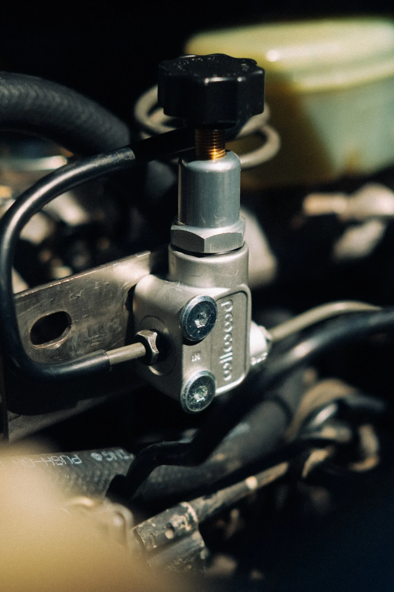

finally got around to fully deleting the ABS and LSPV on Duke.
The axles and control arms are now clean from any wiring looms Thanks to @NLXTACY (wits end) and the awesome plugs that takes the sensors place. The ABS pump is out of the engine bay, freeing up space And weight. The brakes perform better than they ever have!

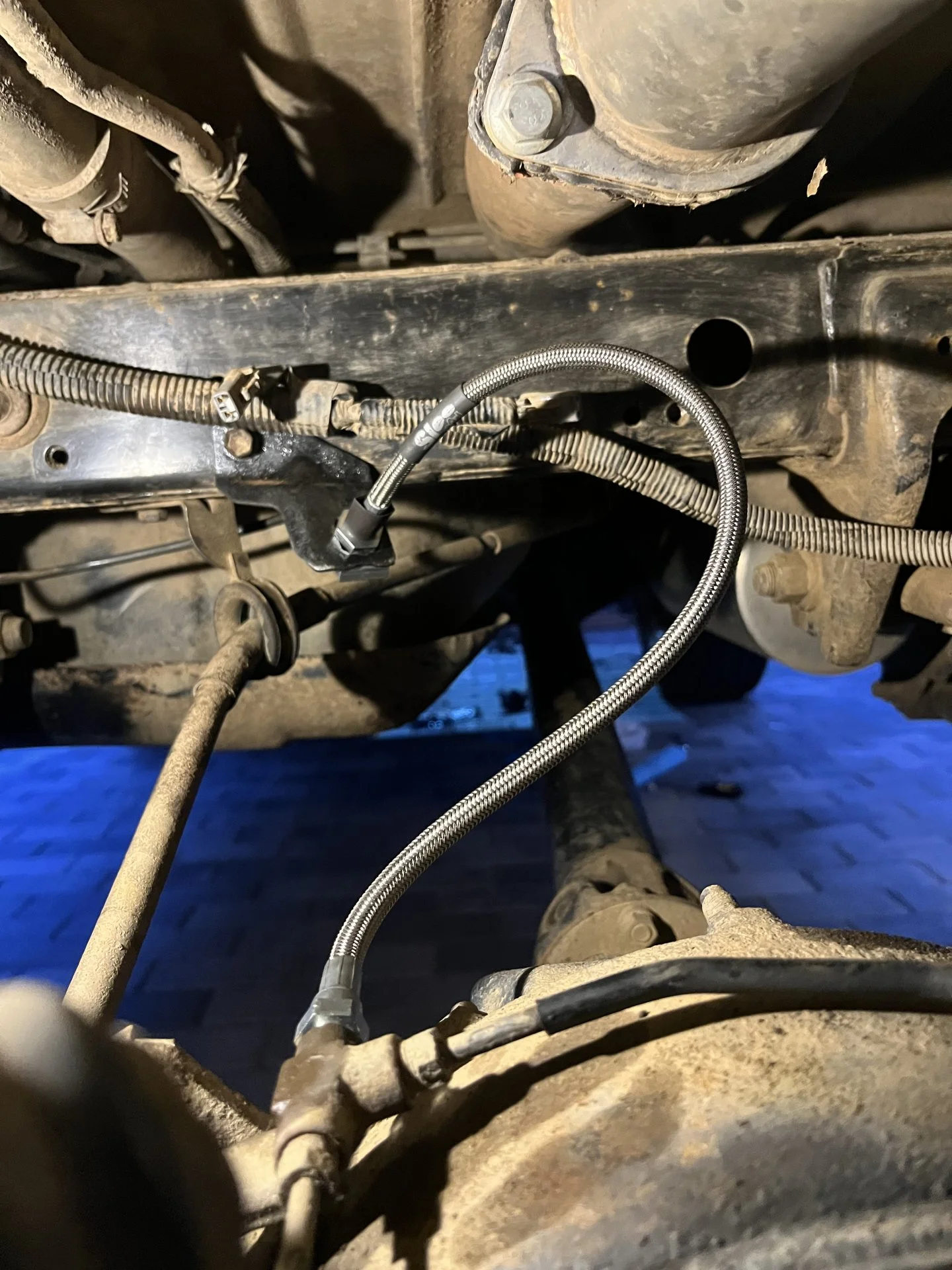

I also installed SLEE extended braided SS brake lines (chassis to axle only).
Overall, it was a painless easy job. A couple flare fittings on the brake lines proved tricky. I broke 2 bolts on the bracket of the LSPV, so i ended up cutting the whole thing off with a Dremel.
