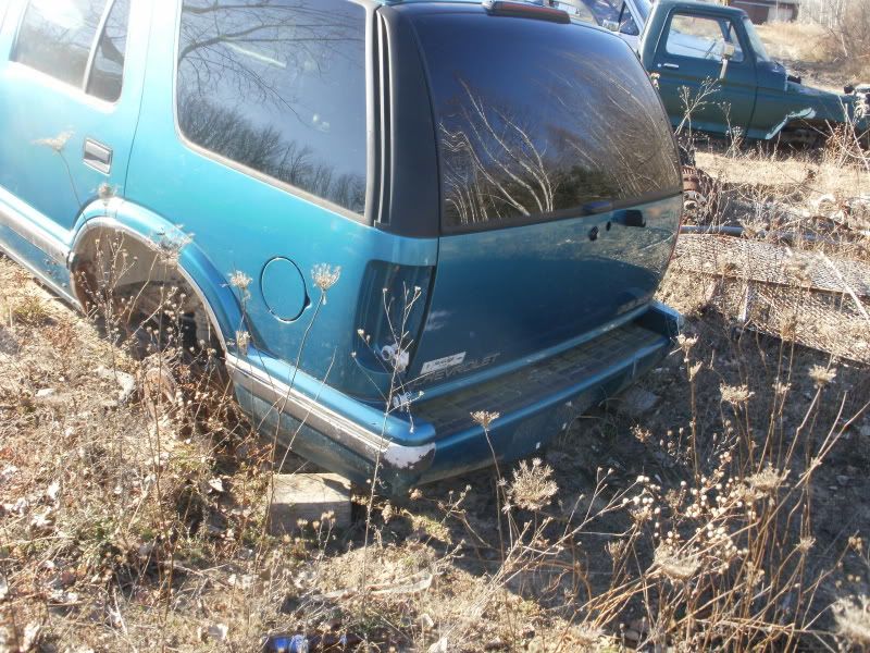

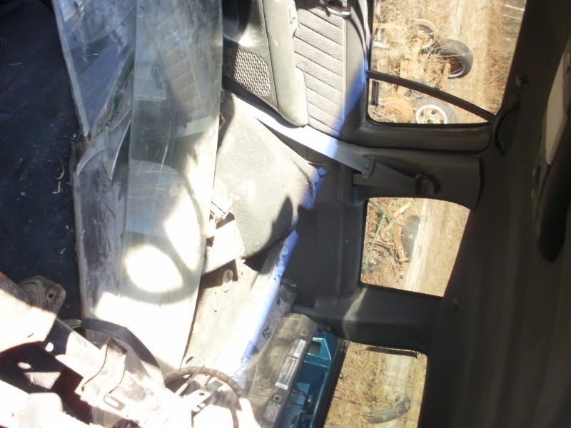

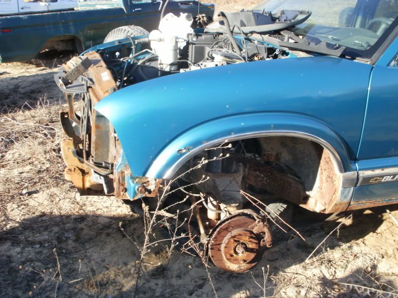

Well had some time to take some picture's of my mess.
