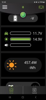

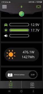

The latest journey is underway. Stops near McCall, Galena Summit, and Driggs ID plus the Flaming Gorge and now it is in storage for a whopping 4 days in Colorado Springs before Camping in the Rockies and...uh...more? It needs a toilet paper roll holder. With running the fridge, freezer, starlink, espresso machine, and all the regular stuff, the battery was at 100% before dark each day. Needless to day, Beni the Travel Dog was thrilled...or napping. One or the other.Snapchat-385643825.jpgSnapchat-413213316.jpgSnapchat-1306255348.jpgScreenshot_20240515_140613_RedVision.jpgSnapchat-1448360420.jpgSnapchat-779779262.jpg

So, I ran the CPAP every night, the Starlink for work Wed through Fri and a couple hours before bed every night. Espresso for everyone, cycled the water heater multiple times, both a fridge and a freezer, and on and on. I never started the Jeep. Weather was mostly sunny. I put the trailer away with 75% battery Monday afternoon and when I went back out to retrieve my laptop charger, it was at 100%.
For 5 days, we used 37.5 gallons of water and over 12kwh of electricity. If I had a water purifier, I wouldn't have had to move.Screenshot_20240527_104341_RedVision.jpgSnapchat-1131320504.jpgSnapchat-1956013352.jpgSnapchat-623549663.jpgSnapchat-173138570.jpgSnapchat-112360368.jpg
