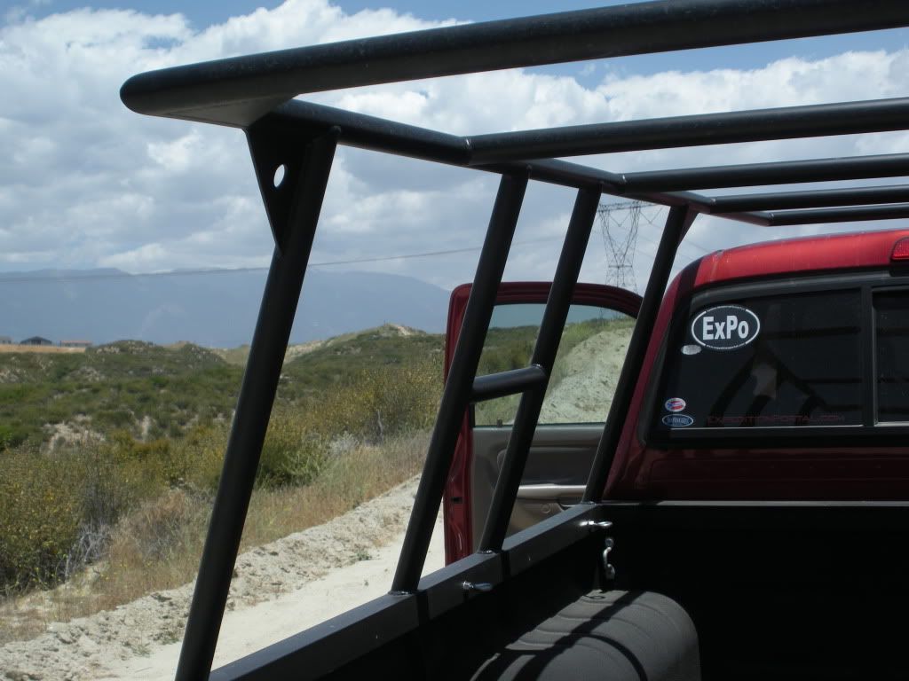

Here's my bedrack. It's pretty simple. All built from 1" square tube with legs made from 2.5" square tube split in half (C channel now) and angle iron feet. I just kinda winged it with this one but it has worked out great. I use it for a RTT, and as two layer bed storage when the tent isn't being used.
with the tent

I went a different way. I like to be able to see out the rear window with as little obstruction as possible, so mine goes above roof line and over the cab. Only to the 'B' pillar.
Side shot. Best side view I have at the moment.
Rear shot.
Total length is 9 feet. No RTT yet, but works for canoe and more.
